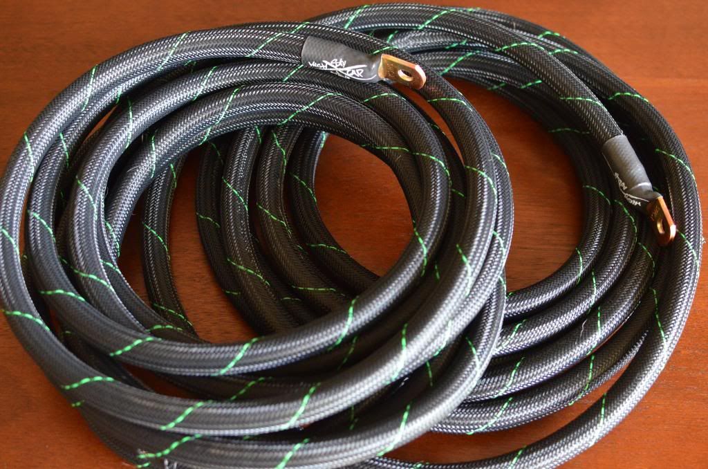

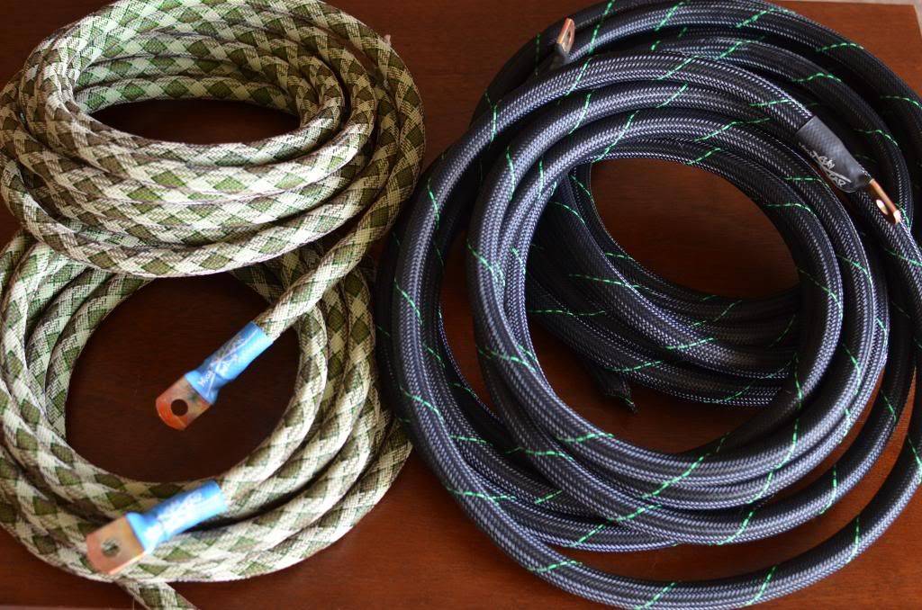

Anyway, got SHCA wire from Jim this week, 50ft. of OFC. Also got this loom:

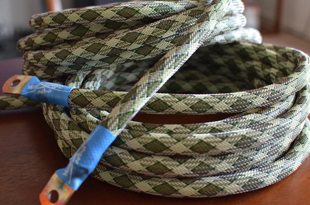

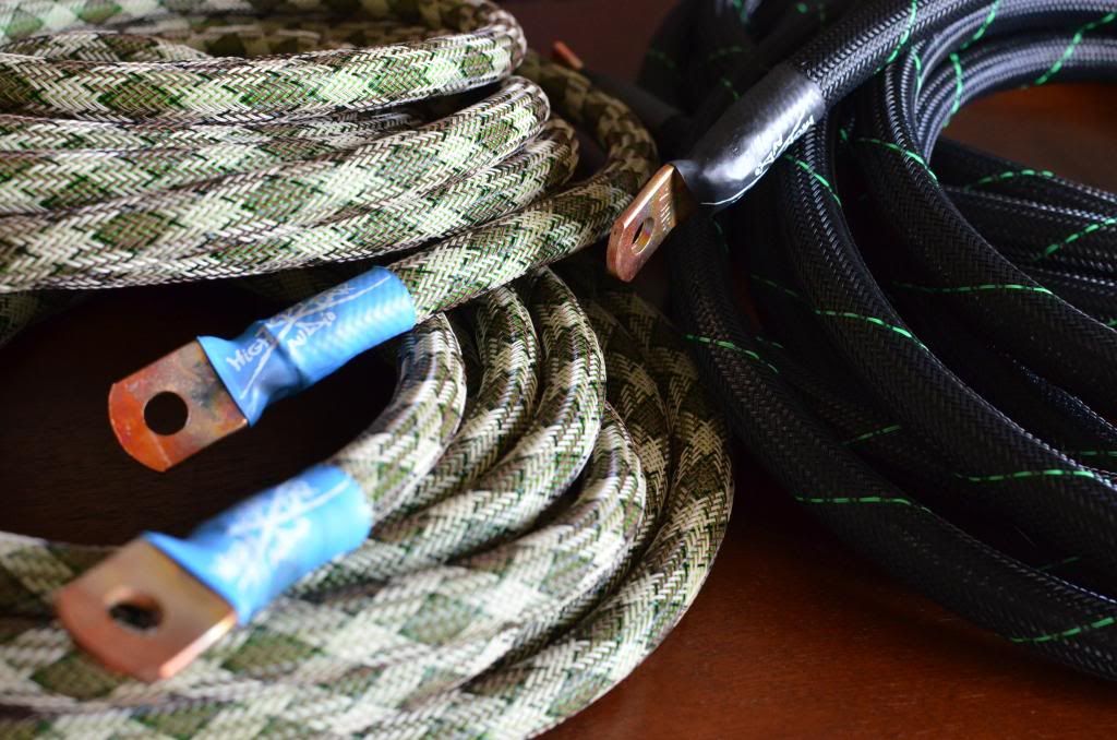

Actually, this was my first time soldering these big lugs. I won't not solder again. **** that crimper! Lol.
Cut my front to rear runs of wire. I measured with rope and gave myself extra, so I'm just praying I have enough once I actually get it in the car. Shouldn't have done it this way, but I am bored. Put the loom on, soldered on one side of terminals:

How did you solder those lugs without openings at the top? fed the solder where the wire enters? It all looks great btw man
Those terminals just have the top opening, so you just melt a pool of solder in there and then shove your wire in. Some solder splashes out, but you can just reuse that on your next one.
Duh ha guess I should have guessed that... never dealt with closed ones like that before. Those subs look sick man, and the radiators, although I see you may be regretting the loss inoutput over ported already:p:
