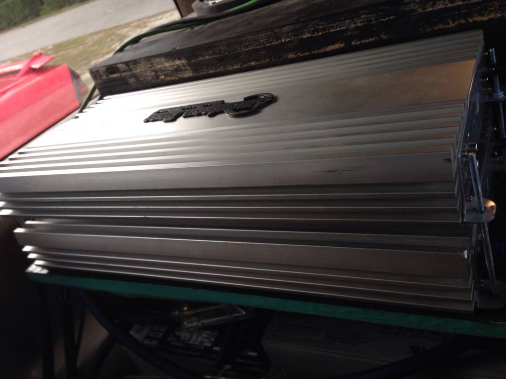

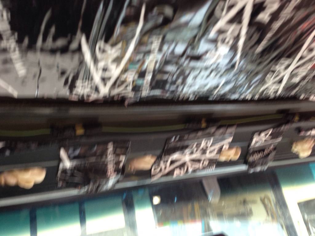

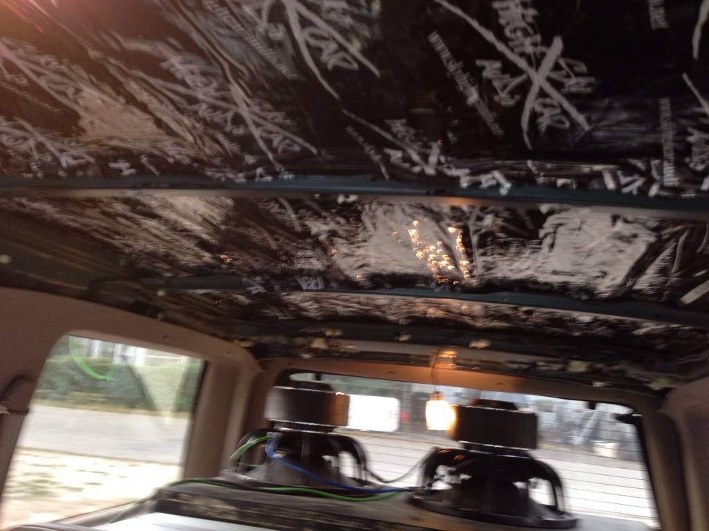

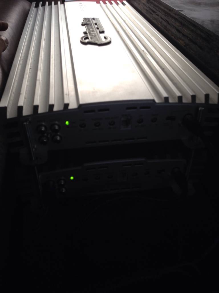

So big update! I got the second amplifier in the amps are strapped at 2 ohms! Seems a little louder might need to tune a bit more! Also got the roof foamed and deadened. Gotta still figure out the doors but it's going good gonna clean up some mess tomorrow and hopefully replace the headliner fabric soon and get that back on the roof!

Voltage is actually better with the 2 amps. And box is braced with some 1 inch wooden dowel. It's not glasses and I don't have any port noise.
Strange. Just seems like you should be getting more out of that.
Sent from my SGH-T999 using Tapatalk
Yeah but I played around with it today while driving and it was a lot more violent today for some reason. Also this is the first time I've ever smelt the subwoofers
Oh god oh god oh god. Stop! You SHOULD NEVER smell the subs. You are definitely clipping your amplifier.
I definitely am not clipping but when I sit playing full tilt for 3-4 songs things tend to get warm
Warm and smelling your subs are different. Have you checked final ohm load?
Yeah I'm still at 2 ohms, although the motors themselves don't get warm like when I was at .5 and the amps are barley getting warm. Like compared to .5 is say their cold haha
Subs smell for two reasons.
You're either melting excess glue from a new sub.
Or
You're overpowering the subs. This can happen from clipping and distortion caused by that which exceeds an amps capacity tremendously. This can also happen from simply exceeding thermal limits from normal not distorted signal (overpowering)
You may be using a dirty song. Songs that have been boosted. Your headunit could also have a boosted setting or something similar that is messing with the bass signal.
Or
So nothing to do with the fact that he's running two 3200W amps into two 1200W subs? You guys really need to give it a rest with this "clipping" boogeyman.
