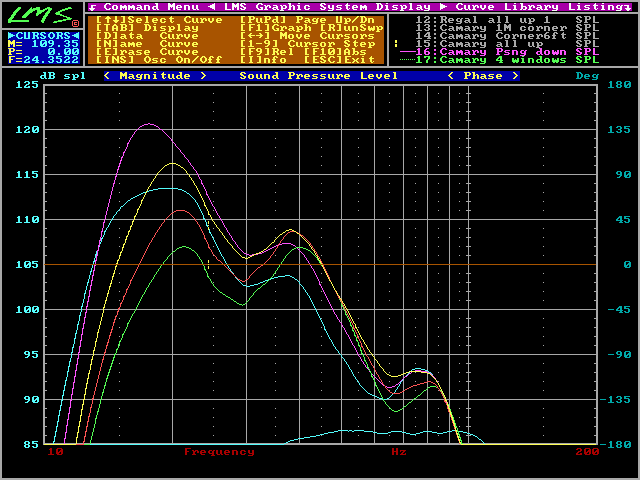

Get a mic, even a basic one(phone) might work at low volume. Basically, do a freq sweep and find the second peak that isnt your box tuning.

From left to right. Left peak is box tuning gain, second peak is cabin resonant frequency. If you tune to cabin freq. They pretty much combine. **** gets loud

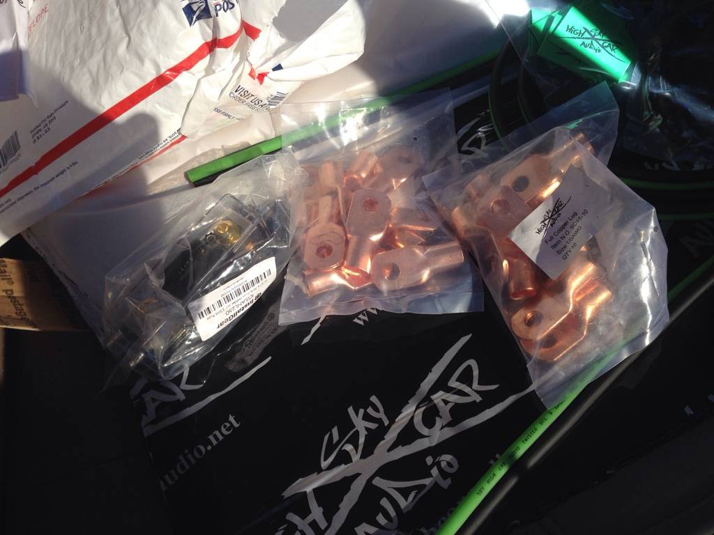

got my sky high deadener! More lugs and heat shrink!! Time to get the roof deadened and the second 175.1 in!!! Also got my strapping RCA and some speaker wire!
