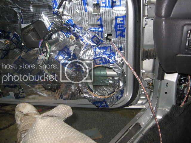

Looks good so far. I'm telling you, lose the rear coaxials and send more power to the fronts. You don't even need them for passengers if you have a proper front stage. Also, make sure you deaden up to and around your baffle for the front 6.5s. I completely sealed my baffle in and midbass response has increased amazingly. Last thing, you should deaden the back of the plastic door panel with foam and deadener. Those things are so flimsy and rattle like crazy. Same with the rear 1/4 panels and sail panels. All the plastic trim in these cars are so flimsy and resonate so much.

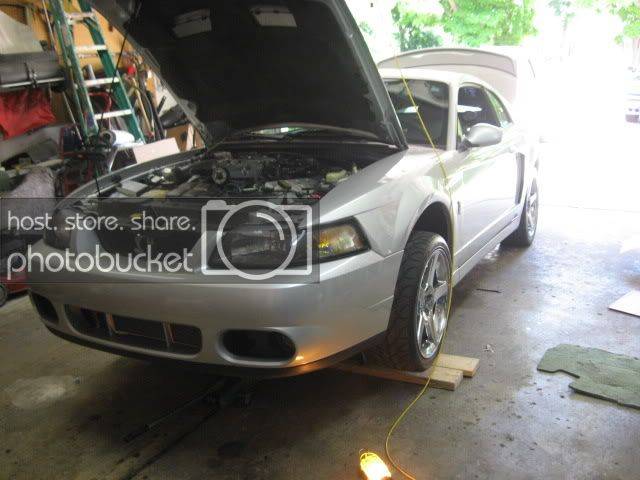

Well I thought Id get much more done today but after 4 1/2 hours of doing the big three I'm beat, I might be doing somemore stuff later tonight but its up in the air... .
Here's some pics
Took 20 min just to get this car up on jacks since its so low to the ground.

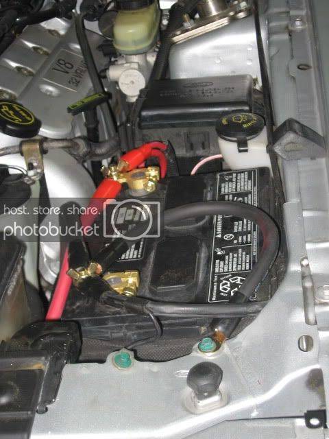

Big 3 wiring (before anyone says anything, the front battery to frame wire is actually in the same position where the stock was located, and yes the paint was removed where it connects.
Where'd you guys ground the engine block to chassis? Pics of that? Also, more pics of the alt+? I started to do my Big 3, but stopped due to not having a jack that can get under my fricken lowered car LOL. Honestly though, I would ditch the rear coaxials and leave the holes in the rear deck to let the bass into the cabin. I've had rear coax in my car and took them out after joining this site, and haven't missed them one bit. Same for my rear passengers...Just a waste of space.

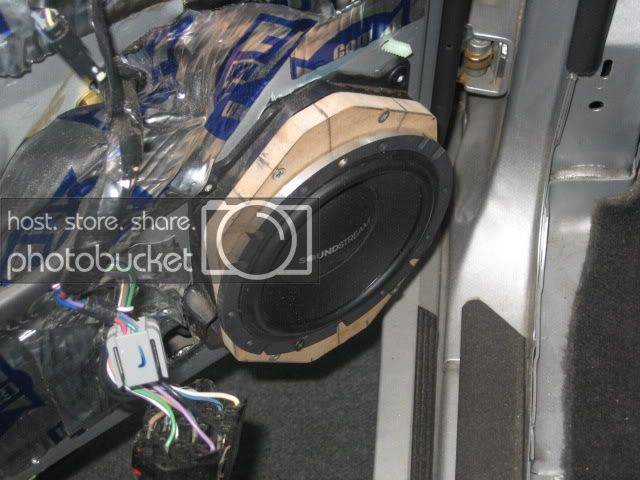

well I got the front stage installed, and all I have to say is that the RF-60 components are some of the best speakers I've ever heard in a car, and the best part is that I didnt even tune them yet!

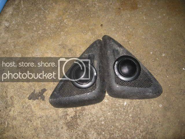

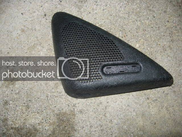

stock tweeter pod
tweeters cut in, still need to wrap new grill cloth around the pod
baffle for 6.5
