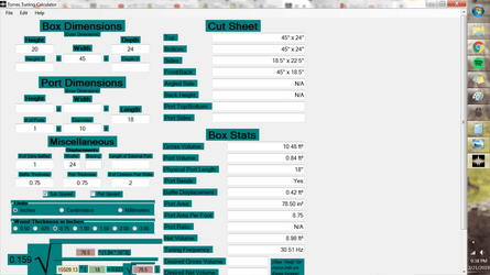

you'll want to sell that sealed box as well. Sealed wont get you anywhere.  If you have an electric screwgun and a jigsaw or has any friends or relatives that have one, I'd recommend you building your own ported box. We can get designs for you to get actual powerful bass performance for the subs you choose. All you need to do is buy a sheet of wood at home depot and have the guys there cut it up to your cut sheets and then take it home, glue and screw and caulk where ever there's a leak. viola custom ported box that'll be 10x louder than your boss 15s ever could dream of.
Here's a sample box size and design for two 15s. subs facing up, port in between them facing the rear hatch. 10 inch sonotubes from home depot will be the port so you dont need extra wood cuts. Box is the most important aspect of getting loud and hitting deep notes.  You can build this box under 50-70 bucks in material.
I'd get the american bass xd 15 D4s, they hit deeper than the soundqubeds IMO and  this amp
https://www.amazon.com/Taramp-HD3000-1-Stable-Channel-Amplifier/dp/B00FGULS78
There's a clipping indicator on the amp so you can actually see when you are overdriving the signal so you can keep sh*t safe and know when is your clean power limit aka no more blown subs, the amp is a solid 2250 watts at 1 ohm with a 40hz test tone.  Best part is, its 4 gauge power and ground like your boss amp so you dont have to spend money on new wire and rewire everything.   The rest of the money will go into the box materials, you can use mdf or 11 layered sanded ply both should be 30 bucks for a 4x8 sheet at lowes or home depot that can cut the wood for you at most you'll need one full 4ft x 8ft sheet and a 2ft x 4ft sheet, some drywall screws and the 10 inch diameter sonotubes. Budget should be under 500 and you'll have a pretty crazy system. You can use the box design I have above, that was for some AB XD 15s actually that does pretty well.
