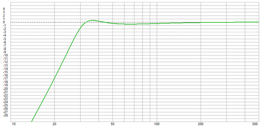

I plan on getting this Sundown E-10 V.3 D4 subwoofer and I am going to put it in a 1ft³ with a 2" by 6.8" round flared port which would have a 32hz tuning frequency. I would use 3/4" MDF and attached an image of what the dB gain at different frequencies and the air velocity of the port. Were and what would people recommend for carpet and piping for the port? Also Should I add some polyfill to the box? Is this a good sub?

A 2inch port is way too small for that sub. 3 inch is the minimum I would use.

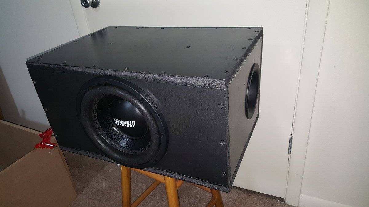

The E10v3 is a highly capable sub, last year I put one in 1.25cf tuned to 34hz and used a 3 inch port.

Did you use a 4" vent that was 26.25" long? Where did you get it?
It's a 3 inch port that flares to 5 inches on either end. The length isn't adjustable so you have to make a box a little bigger to get a lower tuning but hey it's only $4
