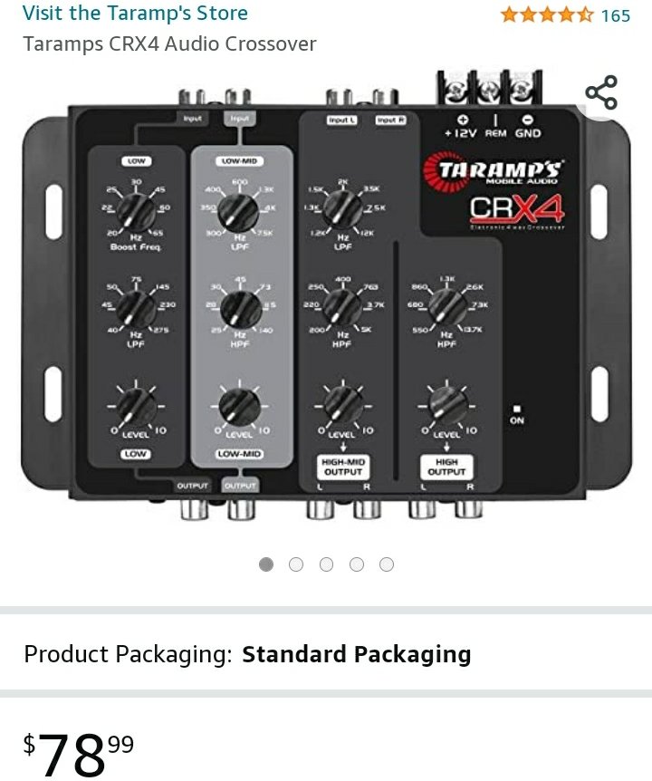

Run one of these.
If you use the crossover in the head unit, then you aren't sending that part of the signal to the amp. (Whether or not that allows a more narrow...
