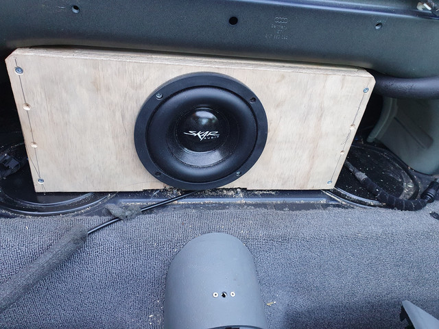

Hi there go easy on me if you could ;) I have had enough of my mk TT Roadster sound so making some upgrades. I have already fitted a new head unit, and yesterday i removed the standard sub which was terrible and added a small sub cabinet and single unit. I don't want earth shattering bass i just want a good punch.

Rear sub enclosure home made with a single driver - ska 6.5inch sub (not glued and screwed yet i know!)

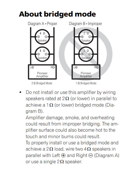

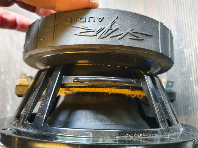

Also can anyone help why i have 2 connectors on the rear of my sub i am running my 4channel amp 3channel (3/4 bridged) do i connect this to one side or both or doesn't it matter? Is it for chaining?
Thanks
Ok done some reading for anyone interested in the answer, my AMP documentation says this for Bridge mode so seeing as it has dual 4ohm voice coils i wire them as below. So i am in effect applying a 2ohm load onto the bridged circuit with my sub coils wired in parallel.
