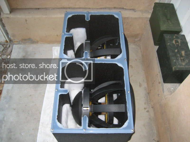

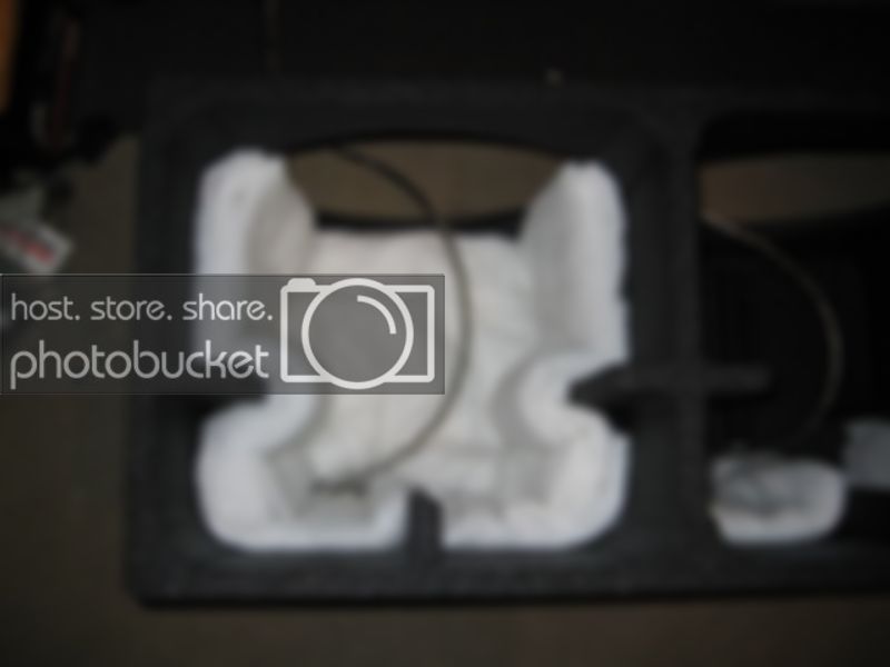

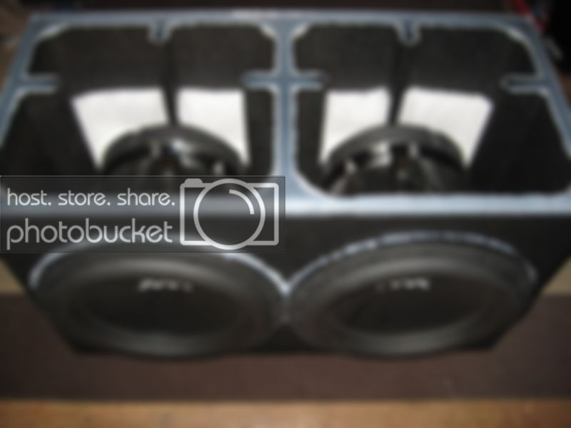

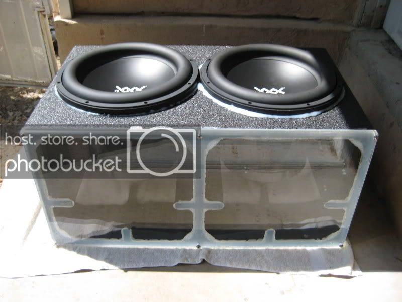

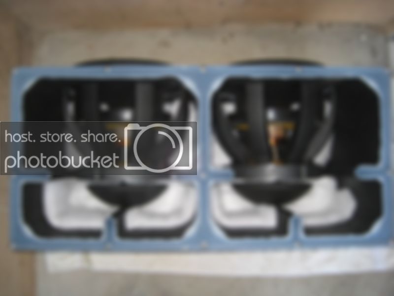

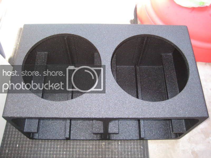

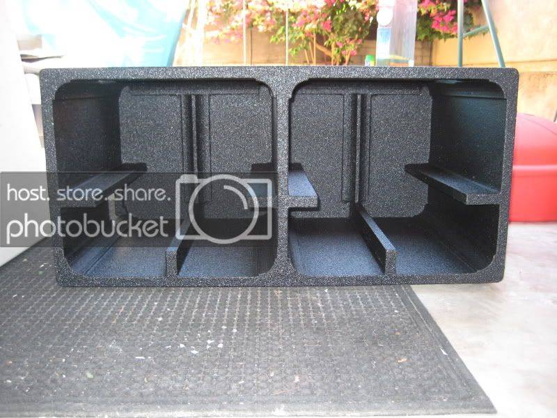

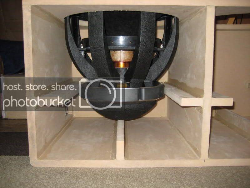

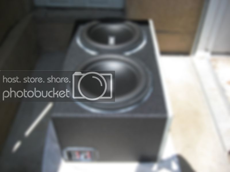

I just thought I'd share some pics of this box before it goes in.
2 15" RE XXX
2.1cf Sealed w/ fill
Braced, Supported and X-line Coated
and Very Heavy!
I think 1 cube per sub is extremely on the small side, //content.invisioncic.com/y282845/emoticons/crap.gif.7f4dd41e3e9b23fbd170a1ee6f65cecc.gif
they recommend 1.6-2.1 PER 15" XXX, unless you mean that box is 2.1 cubes per chamber, your suffocating those things. But your using polyfill, so I'm not sure how that effects it.
BUT, aside from that, the box looks REALLY nice and I'm loving the plexi side, although I wouldn't exactly show off a box with polyfill, just doesn't look that purty to me //content.invisioncic.com/y282845/emoticons/tongue.gif.6130eb82179565f6db8d26d6001dcd24.gif But great build and really clean job man, hope you like it. Let us know how it sounds //content.invisioncic.com/y282845/emoticons/smile.gif.1ebc41e1811405b213edfc4622c41e27.gif
Is line-x in a spray-can or is it sprayed with a gun / compressor?
may be just me but that box look really small for those subs
The MFJ recommends: 1.6 - 2.1 cf Sealed
So it's at the top of the recommendation..
Yes it seems small but if you have a little extra power and EQ then it will be ok. (and in the car)
looks nice!!! One thing though.. I think it would look better if you taped off the plexi and painted a wide black line on it to cover the sealant on the bracing. Or make a piece to cover it and spray it with some more x-line.
just a thought
