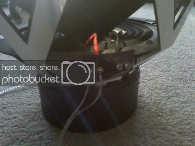

Wring a 1 ohm sub to a 2 ohm amp diagram?
where are you getting 4 wires to get 1ohm? it's duel 1ohm. that means each coil is 1 ohm. so it's not a 1ohm sub. it's a 1ohm duel voice coil sub. how are you confused about how to wire it? you can't get any easier than the pic i put up already.
what are you wiring the wires to though? The sub would only have 2 terminals on one side, and this is saying to wire the sub with one positive from one side going to one negative on the other side,a nd then run a wire form each side to your amp. Is this just a relative diagram?
your sub is a dual 1 ohm sub right?
that means the sub has 4 terminals...
if it doesn't then you misinformed us...
if it does the pic is exactly right...you have 2 wires to the amp from the sub and 1 wire jumper from 1 coil to the other on the sub ...just like the pic...

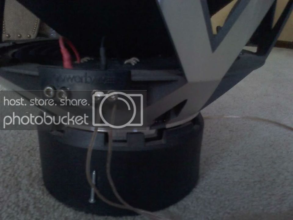

Just to clarify, was it supposed to go something like this?
And then I had the two wires from each side that werent connected to each other connected to the box, then the amp going to the box this is correct?
