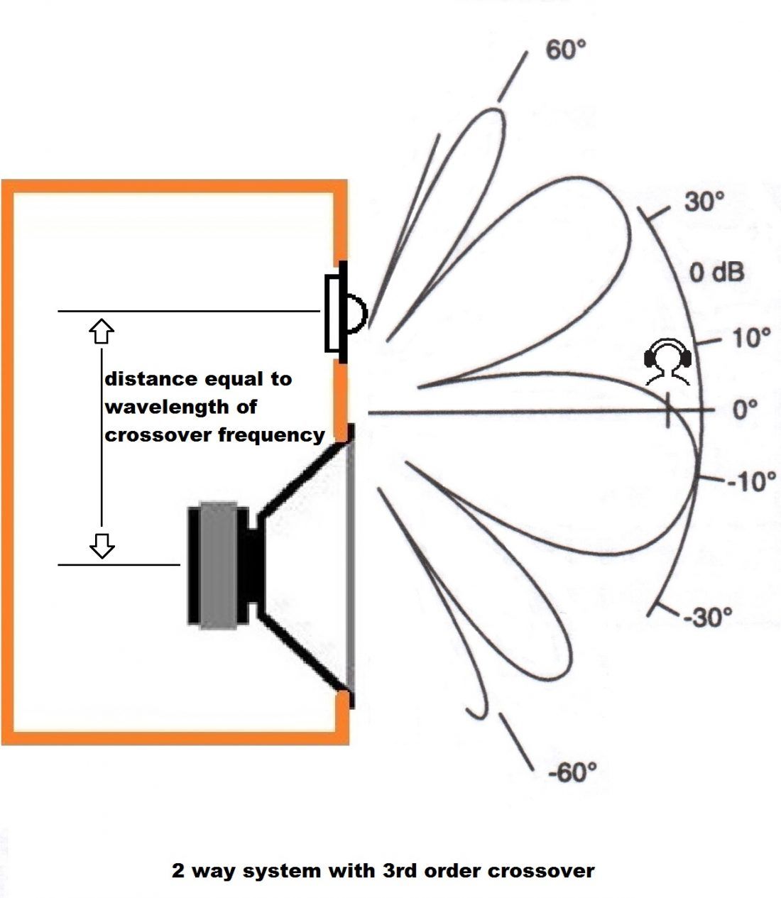

I know you're supposed to have your tweeter as close to and on phase as much as possible to the midwoofer when it's a 2 way component set. Should I expect any weird anomalies or imaging issues by setting up a 3 way like this? Never done a 3 way speaker system (woofer, mid, tweeter)

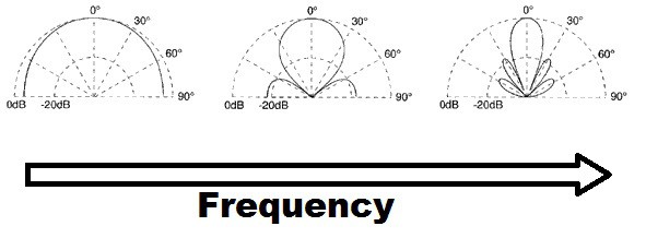

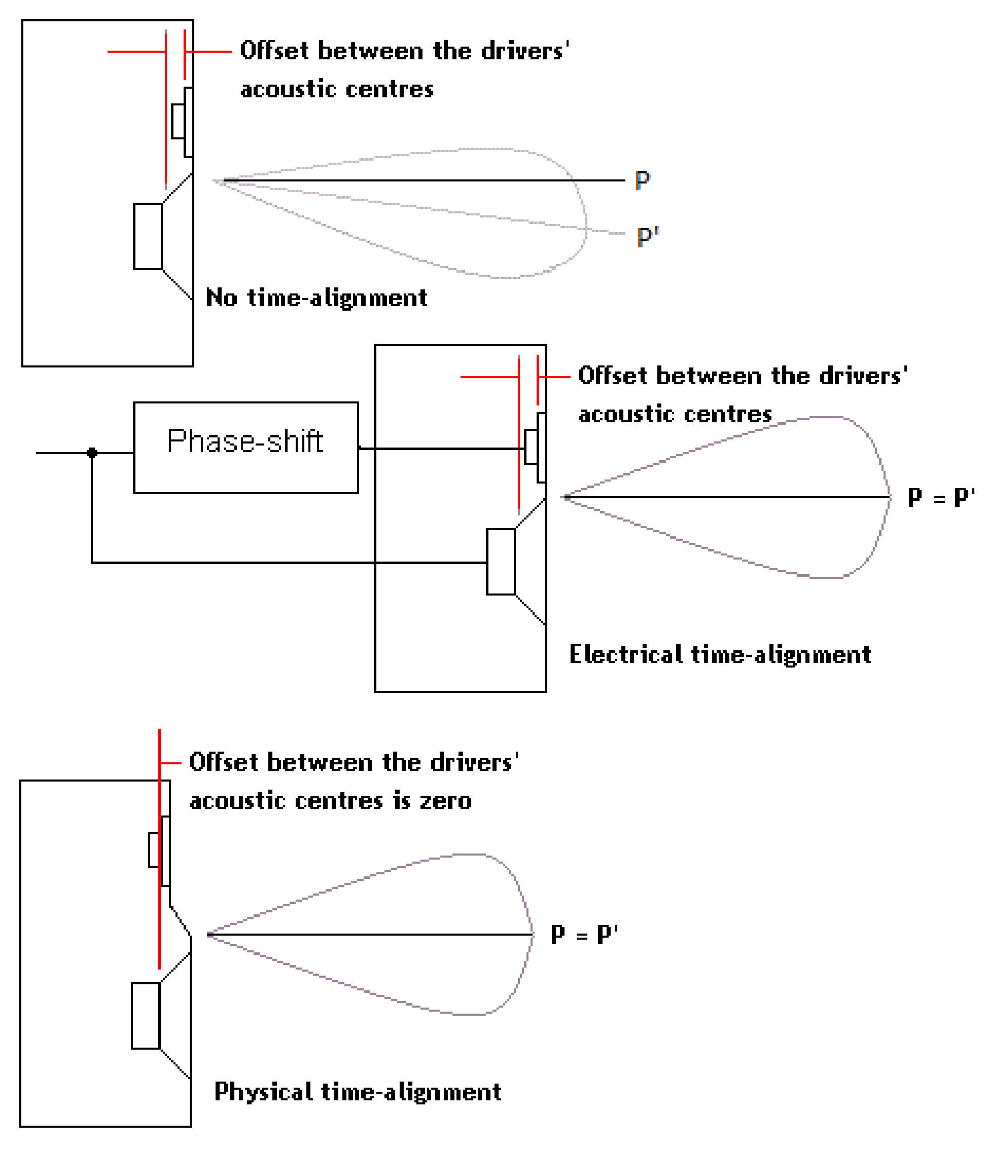

Study acoustic lobing:
Example:

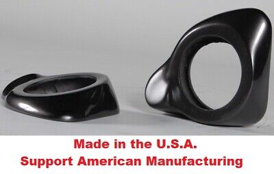

Does anyone make kick pods for that truck for 6.5's? Just a thought.

LOL. Started to say. Ive had a few sets of the Q logics. Kind of expensive for what they are. I ended up with surface door pods and made some out of F.Glass later on, and bought a set of door panels at a Yard and cut those as needed to add ect. and kept my existing to replace back to STOCK if ever wanted too. Same with A-Pillars
