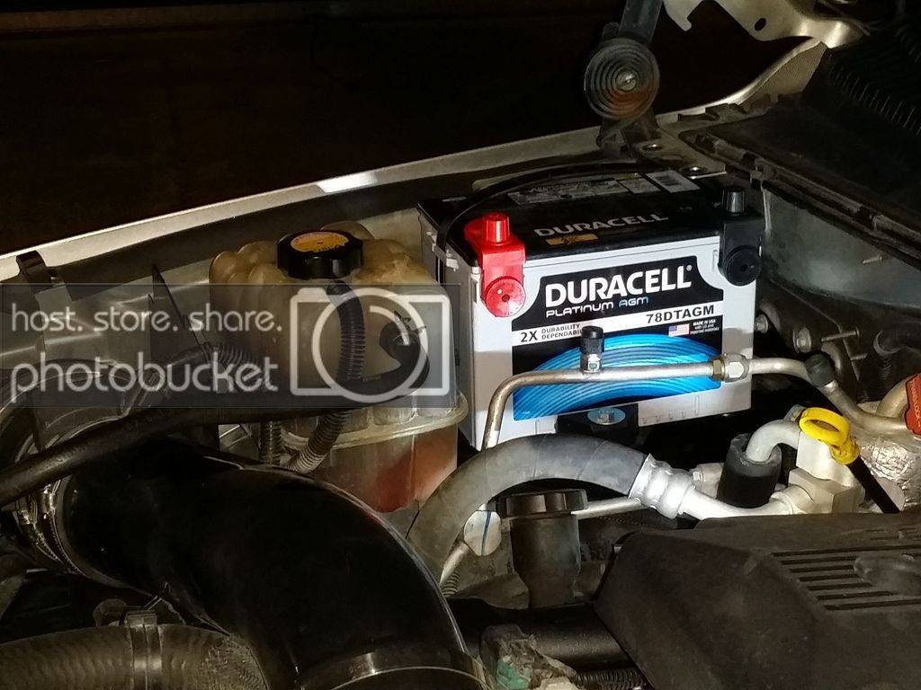

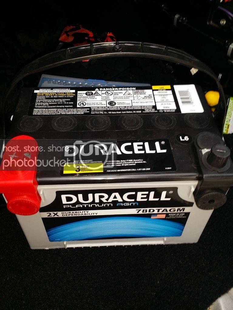

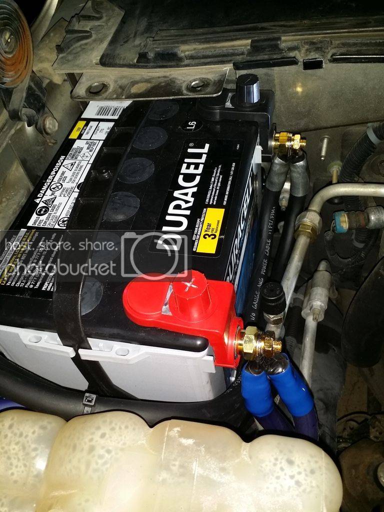

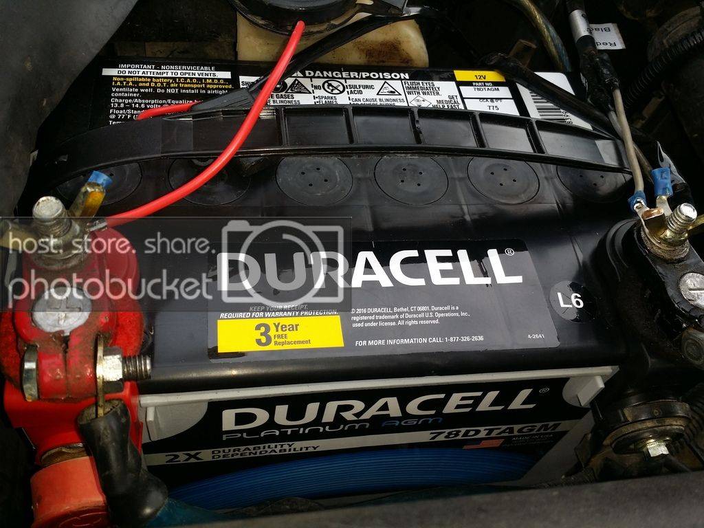

Measuring doesn't work all the time because sometimes you never know when they are measuring from the top post or just to the top minus the post. The Bosch platinum I had in there is measured wrong on pep boys website as far as the height. The Kinetik and XS power can stay on the shelf because I went cheap. I got 2 Duracell agm Platinum batteries to go under the hood, and I already have 3 batteries in the back that have about 100ah a piece. I read somewhere that some guy said he was having problems closing is Tahoe hood with the hc1400. That's why I didn't bother with Kinetik. The hc1400 was supposed to be a direct fit, but I didn't want to take a chance. The Bosch battery was leaking acid and the acid destroyed my hose to the windshield wiper reservior. It won't look like the pics after I finish running the new wires, and get an alternator.

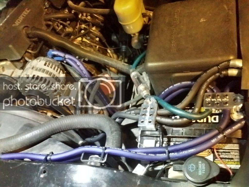

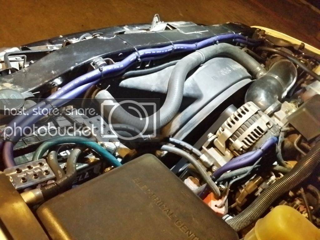

These batteries are pretty good so far. I still need to run 2 runs of zero to the back. The turquoise looking wire running to the back is Cadence, and it has corrosion so bad that you can see it through the jacket. I still need to order some more power wire to complete it. Everytime I crank the truck the voltage is higher than it use to be, but I think the big 3 upgrade is responsible more than just adding another battery?
