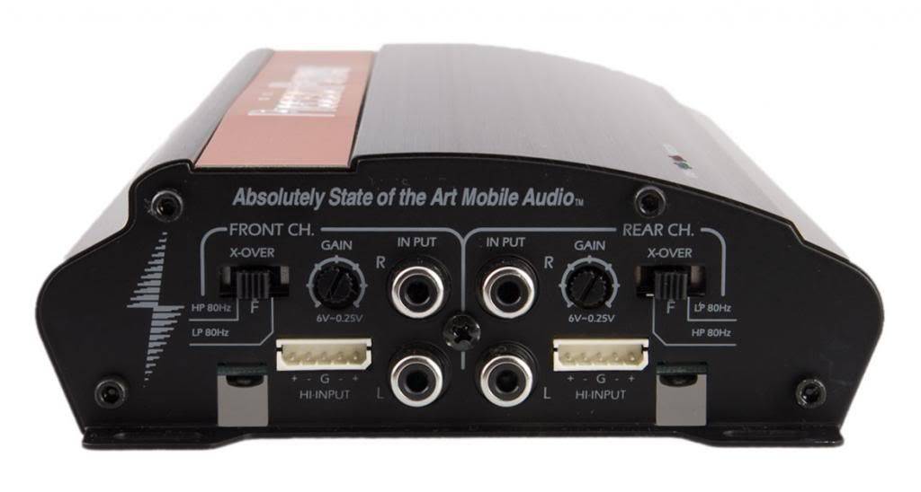

No, there are 4 channels for pure power and 4 channels that have passbands you can set to cross over the mids and highs.
These are a comparison between a non active capable amp vs an active capable amp

You can take it a step further and get an active processor, I know there's more but the first thing that comes to mind is the 3SIXTY.3. That way you can set your crossover points and slopes way more accurately than just a knob. That's one of my pet peves. Like, say I wanted to have a high-pass at 3.5khz on that amp mentioned above, where would I set the knob? It's somewhere in between 500-5000hz on that knob lol.
EDIT: Also another thing that comes to mind when using only the amp's options to go active, is that you can't change the slope of the crossover point. It's going to be set at 12db/octave or something.
