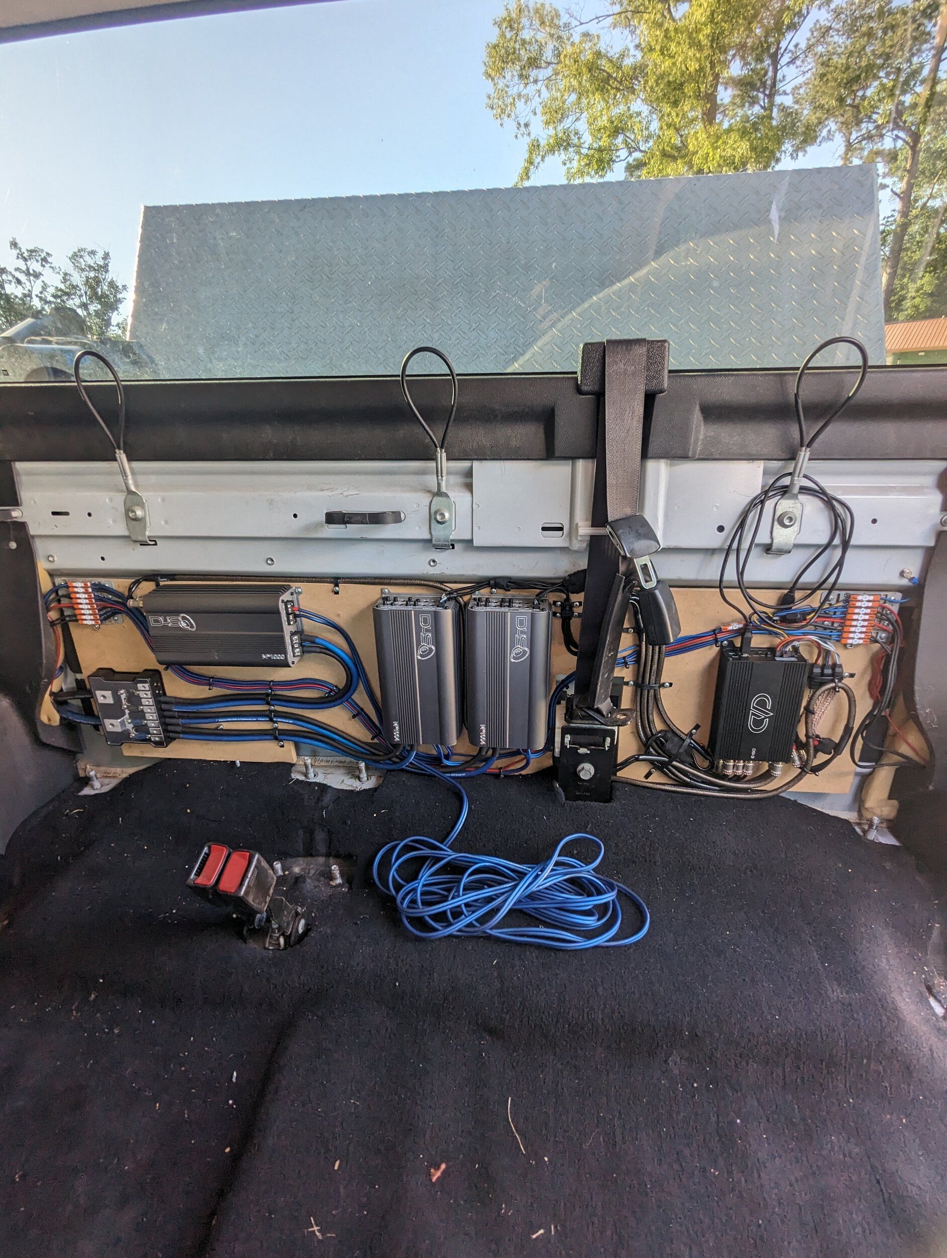

Personally that the one part of my system I wished I would've went custom on the rcas but only because of the lengths and how it can tidy up an install.
I'm definitely thinking of quality RCAs and a proper length . . .
Mine were as short as possible and still I had issues routing them cleanly
