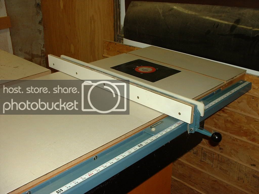

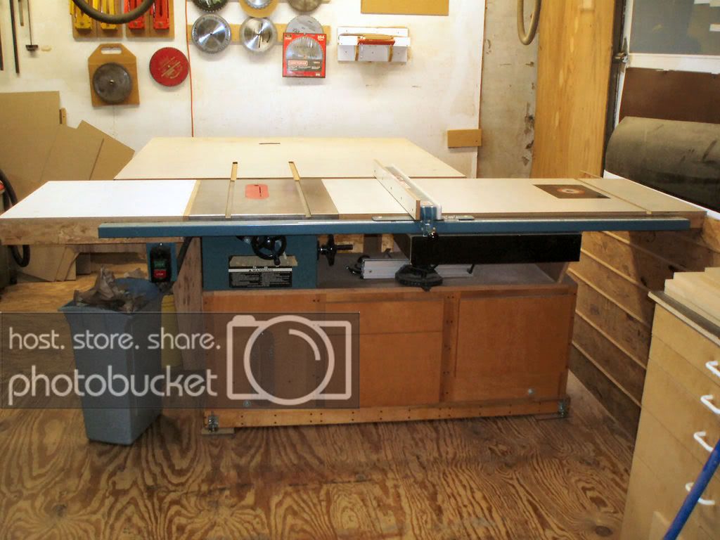

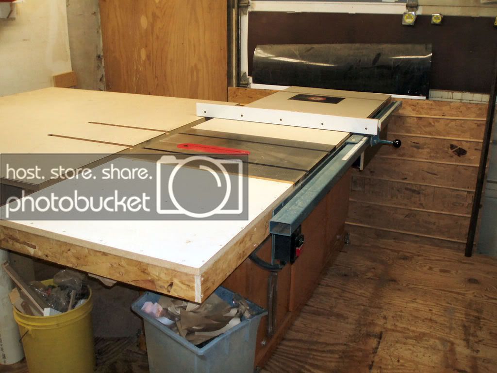

BTW, here's my Tsaw - JET 708300K / JWTS-10CW2-JF 10" Table Saw w/ a Jet 708957K Xacta Fence II JET Homeshop 52" Fence mounted on a custom fabricated rolling cabinet base I built for it so that can be set level to ensure cutting stability and accuracy.
The saw with the fence system cost me less than $ 800.00 keeping in mind that was back in 1998.
