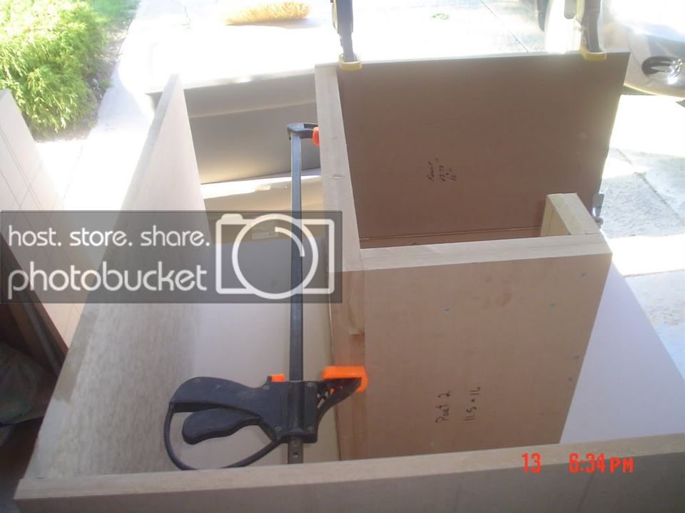

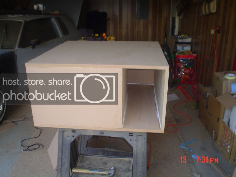

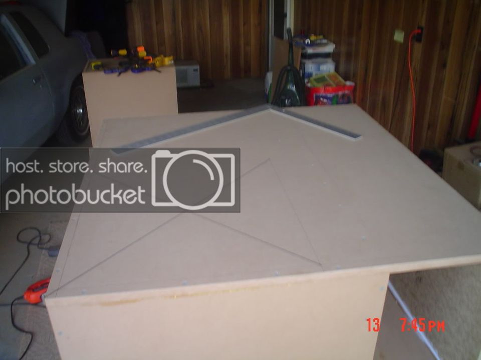

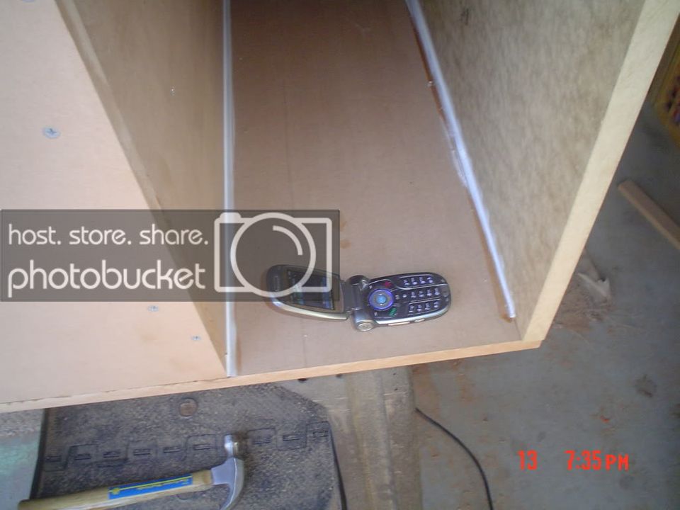

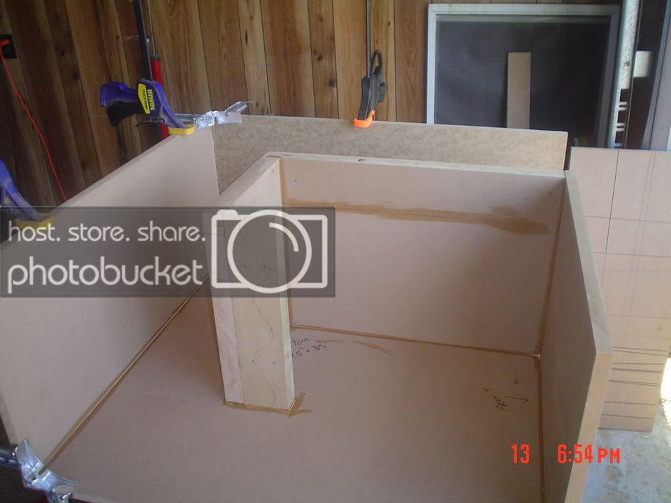

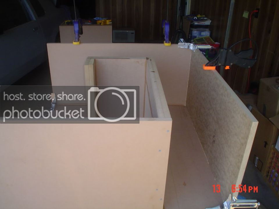

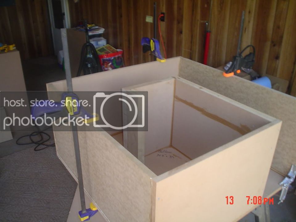

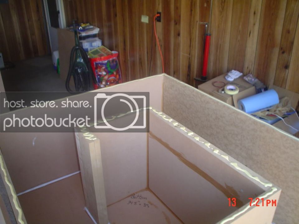

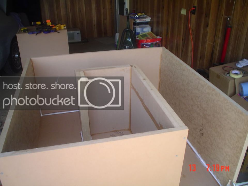

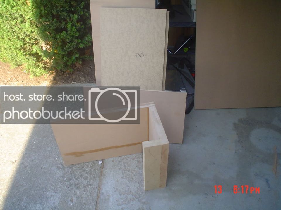

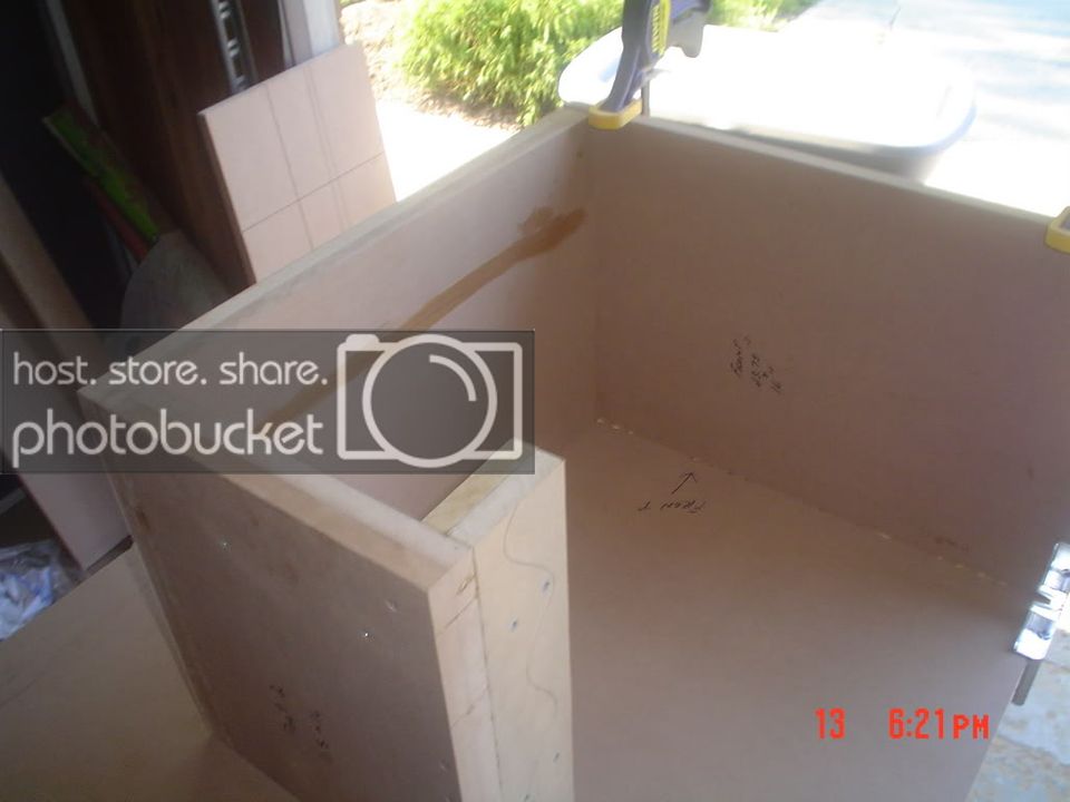

Ok here is a nearly complete fartbox built for WhiteIce.......3.5^3@40 htz 160^2 in port. The only other things i have to do is cut the hole..i'll wait til his sub comes in..and i need to double up the outer port wall...and possibly the top baffle. Simply put....i ran out of MDF. It took my slightly under 4 hours including cutting the wood with my circular saw.
Anyways....enjoy
