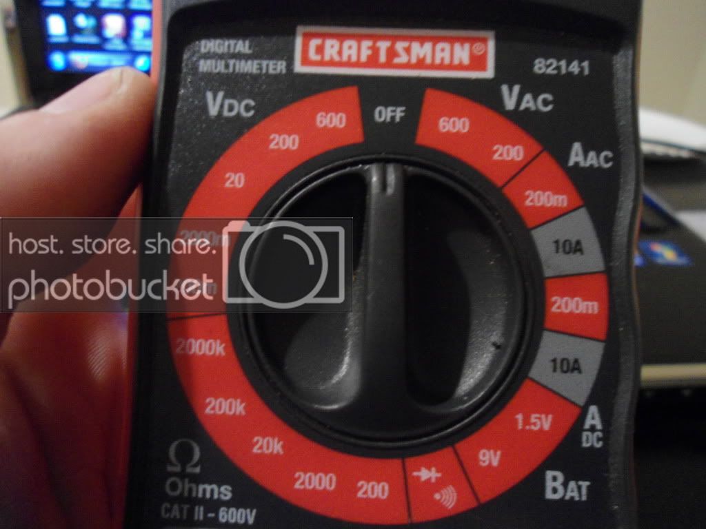

Here is my volt meter i am borrowing from a friend as i cannot find mine >.>
i used the 200 for ohms and it read out .8-1.1 on my speaker terminal so i think thats for my speaker but i don't want to blow out anything...
which one should i use for:
A. Testing the battery voltage
B. Testing the 2 wires in the back of my car voltage ( and should this be any different from battery voltage? i would guess a little.. )
C. testing my amp voltage when setting to ~31.5V on the speaker output
D. setting the subsonic etc.
not sure which one / on the amp which holes to use the amp power or speaker etc.

For a and b set it at 20 vdc. For c and d use 200 vac but prob won't be near as accurate. When using a manual multimeter start with the largest number then switch down until a more appropriate reading is attained. If you start too low you may pop the fuse in the meter.

yep i have a meter just like that one.
thanks, the 20vdc worked great.
200vac is what i use for setting the voltage on my amp? how do i set subsonic and such
just downloaded a 50hz tone and a 32hz tone for setting the amp, i will use the 50hz on repeat, but the 32hz with the woofer just to see what it sounds like first time on //content.invisioncic.com/y282845/emoticons/smile.gif.1ebc41e1811405b213edfc4622c41e27.gif
On your tone I first used a 0 db tone and it didn't work for me cause I listen to rock and country as well as rap. I use a remote level with my amp for the differences but a hu with a subwoofer level would work too.
