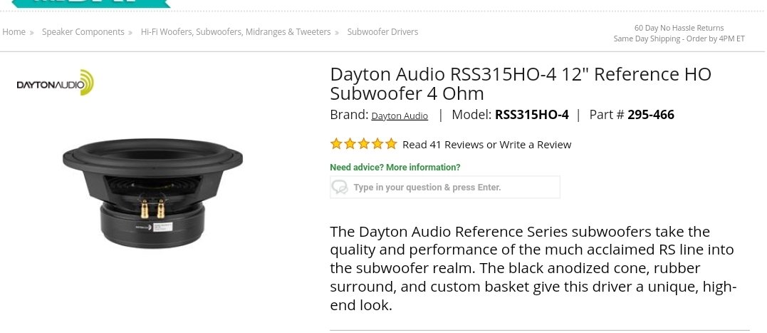

@denim
excellent sub for sealed applications. Good xmax.
