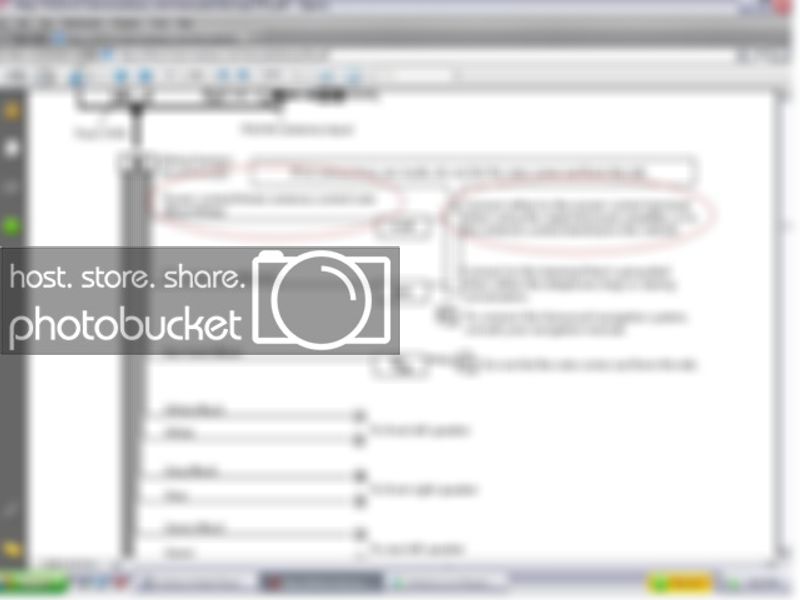

Where do the wires go?
out of my manual
the remote wire goes into the back of your headunit
you're also going to need an RCA cable going between the amplifier and the headunit
