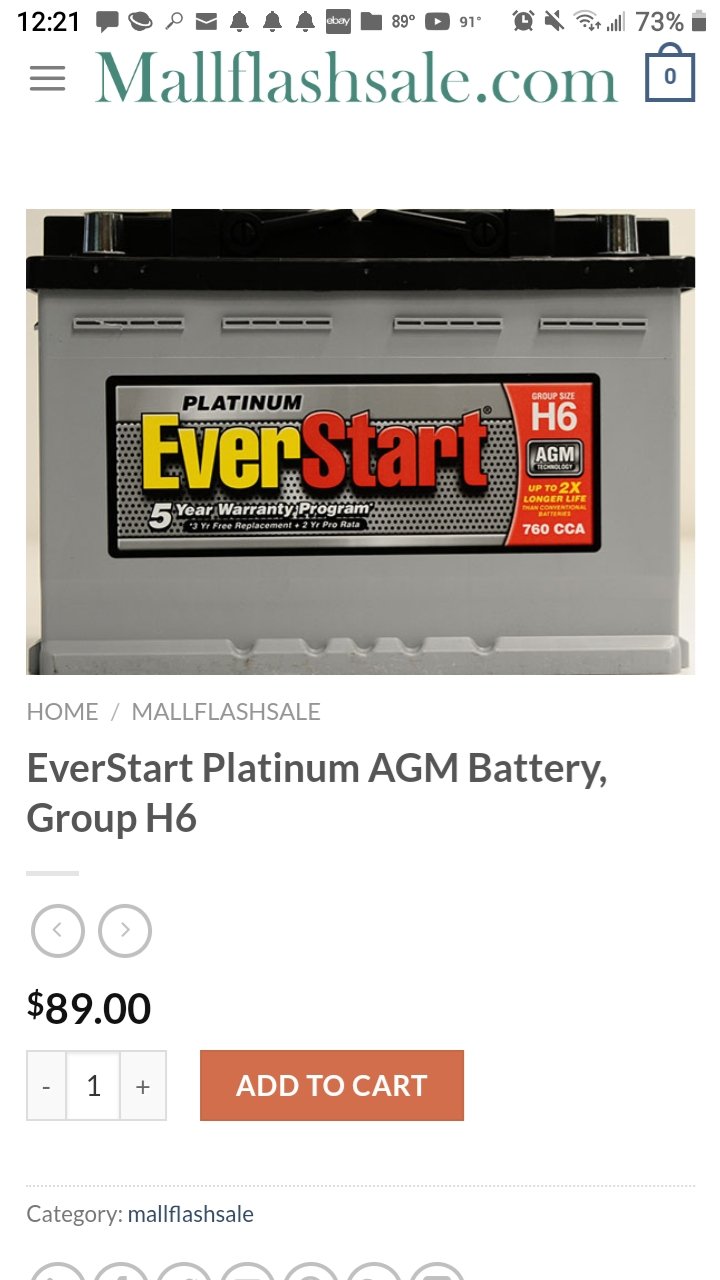

Not all batteries in this comparison are AGM, but it does show that more money doesn't necessarily equal more performance. The only meaningful difference is going to be the warranty and the price; that marketing ain't cheap.
Not too mention there is only 4 makers of batteries in the US and iirc 2 overseas. Maxx Everstart Group 65 for example is made by Johnson Controls. They make a LOT of the batteries you see out there. Same one I have in my Explorer.
