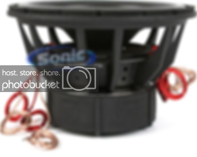

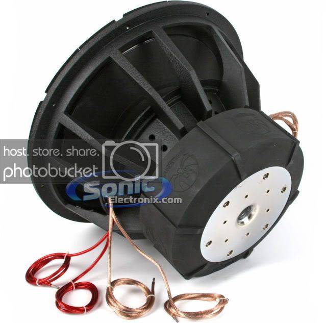

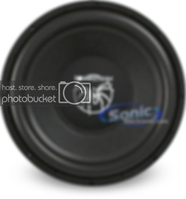

I was wondering whats your opinion on this sub?
Soundstream XXX-18"
The XXX-18 is optimized for large vented enclosures. Suggested volumes are included for 4ft3, 6ft3 and 8ft3, but it can go in larger enclosures if desired. Specs are as follows;
Fs 22.9 Hz
Vas 5.504 ft^3
Qms 5.866
Qes .191
Qts .185
QVC Quad 1.2-Ohm Coils with 10 gauge leads – no crappy terminals
BL 19.47
Xmax 30mm
Xmech 45mm – That’s 3.5” of peak-to-peak excursion for you tweaks!
2.83v 99.81dB
Wrms 10,000 watts – Not peak, RMS!
the old one looks to have wayyyy better parts such as had 10" spiders ,better cone.
that surrond nore spiders will allow 3.5" of travel. and the coil will not hold 10krms. i have yet to see a coil hold 10,000rms. that means clamped power for ever and not blow.
