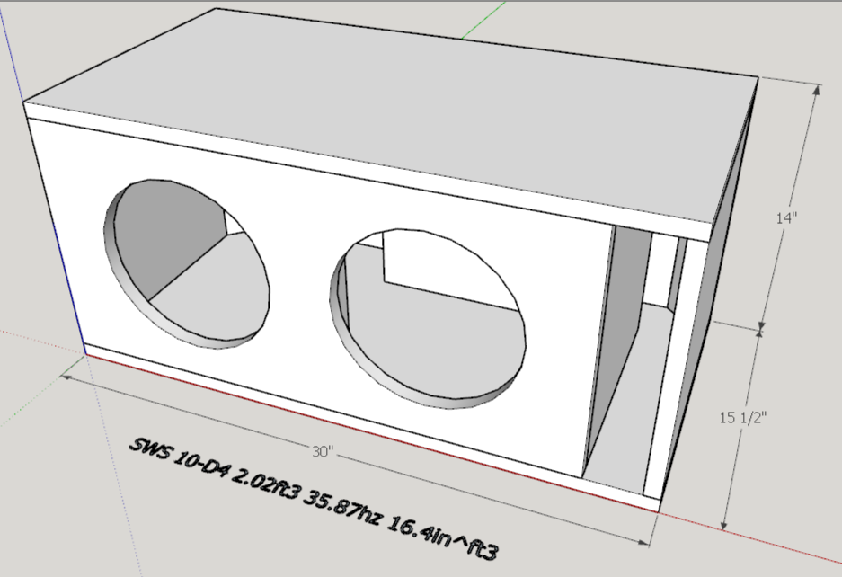

I'm wondering if you got the box built yet? I got a plan for just those subs....
I really don't know if it'll fit or be optimum for your application but it's ported for up to rated power and should do well if it's a configuration that'll work in your vehicle.
