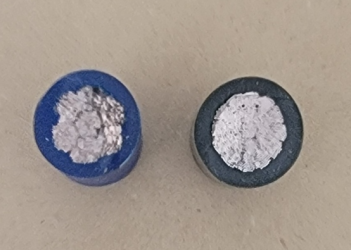

I don't think there is good reason not to. I've got both the Knu and the Anchor 2/0 and the Anchor 2/0 is heavier per linear foot and it is thicker than the KnuKonceptz. I can use standard 1/0 connectors on the KnuKonceptz, cannot onthe Anchor 2/0. For the straight runs under my car to the rear, it's flexible enough and since it is a little cheaper, why not. it's a wash in the end as you end up needing additional 2/0 reducers too, something not needed with the KnuKonceptz. Either way, it's all good and it will get you where you wanna go.
Knu 1/0 on the left and the Anchor 2/0 on the right.
