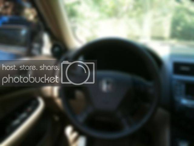

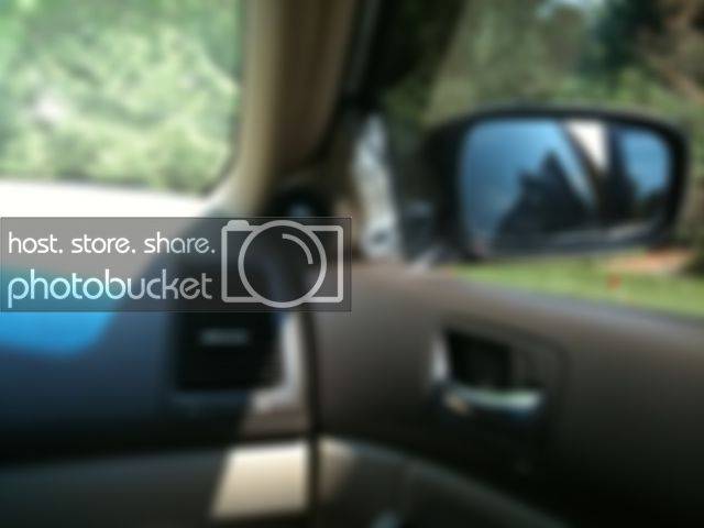

I already had to scrap one set due to the mounting ring shifting while i was stretching fleece over it:

Its hard to be sure just visually, but aiming on those tweeters looks way off. The passenger side one appears to be aimed directly at the driver's face, while the passenger tweet looks like its aimed at his ankles.
Again, may just be the pics and/or viewing angle, but I thought it was worth mentioning.
yea that was the screwed up set that i had to scrap. i cant get any glue to stick to the polypropelene plastic piece, so when i glued the mounting ring to it, the ring shifted while i was stretching fleece over it.
