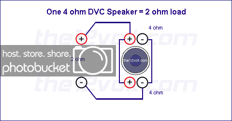

I'm looking at the wiring diagram and punching in the 4ohm dvc or 2ohm svc only showm me to to connect them to a mono amp.
So your saying 2ohm svc just wire them normally each to an amp channel or 4ohm dvc in parallel ?
yes.
If you buy 4 ohm dvc subs, wire them like this:
what about 2ohm dvc ? do I run each to each channel ?
- A single 2 ohm dvc sub can only be wired to 1 or 4 ohms, which means you won't be able to get all of your amplifier's available power unless you run two pairs of them.
- There are several possibilities. Your amp does 125 watts rms x2 @ 4 ohms, 200 watts rms x2 @ 2 ohms or 400 watts rms x1 @ 4 ohms. This means you have several different configurations that you can choose from. I'll list a few of them for you.
Four 4 ohm svc subs: Each pair wired to 2 ohms. Two subs per channel
Four 2 ohm dvc subs: Each pair wired to 2 ohms. Two subs per channel
Two 2 ohm svc subs: One sub per channel
Two 4 ohm dvc subs: Each sub wired as I showed earlier in the thread. One sub per channel
One 4 ohm svc sub: Bridge the amplifier to obtain 400 watts rms x1 @ 4 ohms.
One 2 ohm dvc sub: Bridge the amplifier to obtain 400 watts rms x1 @ 4 ohms.
There are other options as well, but the ones listed above should cover pretty much anything you'd want to do.
