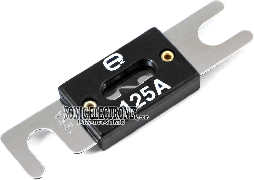

Hello i have a 4 channel amp and a mono amp and together they need 125amps. Right now i'm running a 80 amp fuse next to the battery on 4 guage power cord. oviously the amps are not getting enough current because every time i turn the music loud the fuse doesn't break but it over heats i guess and my sytem shuts down, then i take the fuse out put it back in and it works, my questions is should i put a 125 amp fuse???? Also what is the max my car can handle on a stock altenator and battery, it's a sunfire gt , i think the max is 120- 125 but i don't know... thanks
Your 4 awg should be good up to 125A, but you would be much better off with 1/0 fused to 250A to a distro then out 4 awg fused to 125A to the amps.
I agree. This is how mine is ran. I have 1/0 to the back, fused at 300A. Then at a distribution block it splits into 2 4 gauge wires. One is fused at 50A, and the other at 120A.
So just to confirm i don't want to spend money on a wire just yet so if i leave the 4 gauge for now would you guys recomend putting 125amp fuse or 150...?
Wire Gauge Recommended - Maximum Fuse Size
00 awg - 400 amps
0 awg - 325 amps
1 awg - 250 amps
2 awg - 200 amps
4 awg - 125 amps
6 awg - 80 amps
8 awg - 50 amps
source
