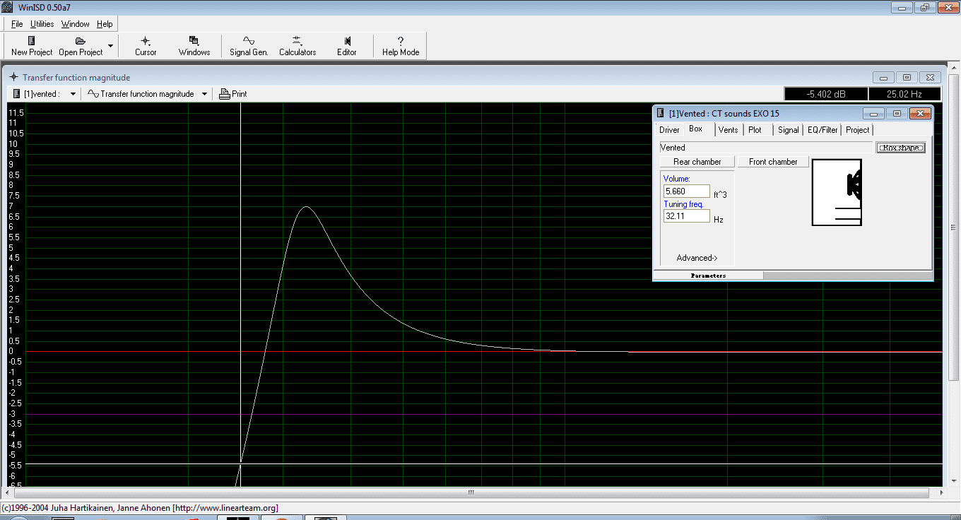

That's 1.5" baffle only like the drawing?... tell me the driver and I'll try to account for displacement... maybe model it... what do you plan?

What's displacement on that?... i can look it up... if your changing subs lemme know... I'll use the new one to model it if you'd like
The newest one will be fine to model off of. As of right now, that’s the plan. Last I checked it was .25 for displacement on the 15”.

I couldn't find parameters online... do you have them?.. Then I can give you a HARD number.
Or at least the best I can come up with... lol

Here is what I have for the 15”
T/S Parameters
Dual 1 Ohm
Fs 30.796Hz
Qts 0.307
Qes 0.329
Qms 4.573
Vas 36.857
Sorry had to leave for a second... is that area in the drawing that says 4.5" at the back wall closed off? or is it a brace?.. I'd like to try to give ya an accurate result

It does appear to be completely sealed off. I’m not sure why though.
It's either this...
Or this...
Volume depending on the piece I asked about... anyways it ought to be close... looks like 32-33hz to me

Is that for both ports? From my understanding when it was drawn up it was a form of a 6th with 2 different tunings.
