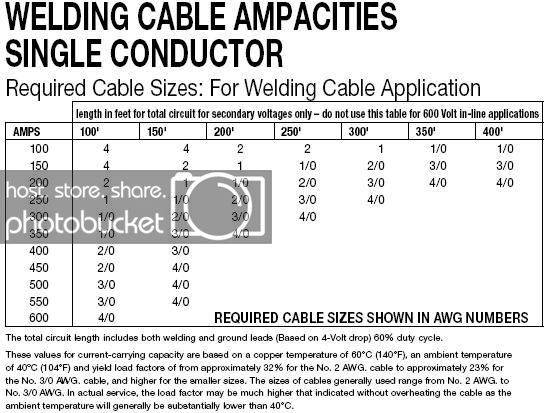

I was wondering the ampacity as well. It's a little different than CA wire, since I'd guess most runs aren't necessarily 20ft or less in welding. It looks like it's 350A for 0-50' runs.
http://www.directwireusa.com/resources/welding-cable-size-amperage-chart.pdf

charts vary, some are by the ft, some are at 50', some are for 100' +. and welding wire is rated for secondary voltage, which is generally 11-45vdc .....not 600 v .....
But the wire and insulation is rated to be safe up to 600vac ....
charts vary, some are by the ft, some are at 50', some are for 100' +. and welding wire is rated for secondary voltage, which is generally 11-45vdc .....not 600 v .....But the wire and insulation is rated to be safe up to 600vac ....
So less than 20 ft I should be good for 350 amps ?
I'd say 350a minimum
