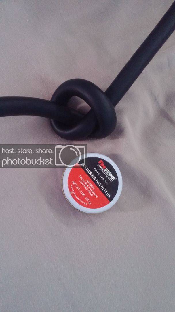

I have 2/0 eb flex wire and its surprisingly flexible for the thickness and weight and the 2/0 lugs i bought are a super tight fit for it
Edit: id also recommend going direct from the source were the make the wire http://www.electronbeam.com/ they always have sales going on i got my 2/0 for cheaper than the reg price of 1/0
Theres a small can of solder flux for the size comparison of the knot
Edit: id also recommend going direct from the source were the make the wire Electron Beam Technologies, Inc. they always have sales going on i got my 2/0 for cheaper than the reg price of 1/0
Thanks for the picture, that's some really nice stuff.
