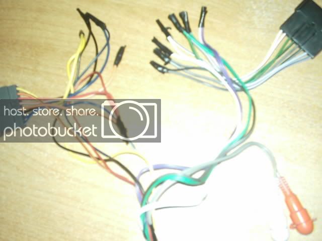

Okay, I went back into everything and looked at it, I was wrong in the original post
This is how the wiring is setup

On the left harness there is a red wire that also has an orange wire attached to it...It looks to be a dimmer or illumination wire. Un hook the orange wire from the red wire, it does not belong there.
Other then that I dont really see anything wrong. If the radio still doesnt work you may have to either buy another one or try and get it fixed.
Lastly, I would go buy some butt connectors instead of useing black electrical tape. They will last longer and be safer then the tape alone.
