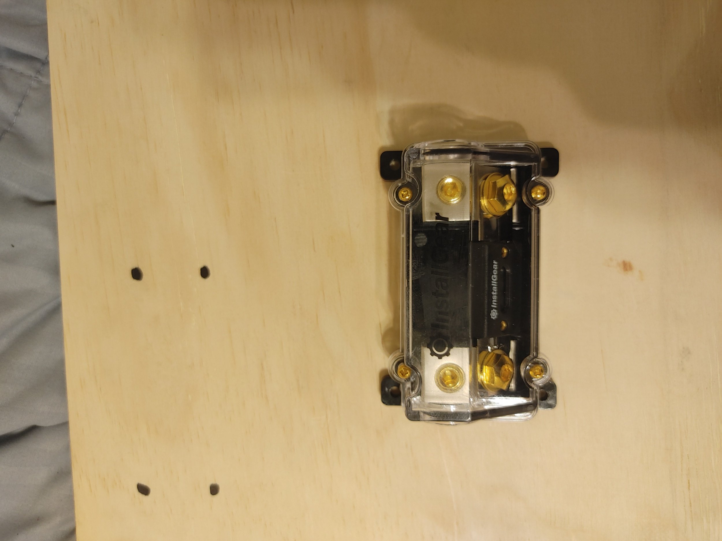

This is the fuse power block I'm using.
Thanks for all your help I really appreciate it.
Ive heard of Install Bay which is pretty decent but not Install Gear. Should work just fine. Keep an eye out on the Interior Housing for any sight of melting. If you see any at all. Replace it before it melts to your wires and Shortens out. Ive had a very expensive Zapco amp that got cooked due to a JL block that was supposed to be rated for 300 amps, and it ended up melting with a 200 amp ANL fuse and shorted out to the back wall in one my trucks years ago. Used Stinger and never had any issues. Just replaced a Nice expensive Kicker one that started melting the housing. Mind you.. All connections are well secure and use ferrules and Heat shrinked as well.
Oh really, maybe i should go with another brand fuse block ?.
I just ordered 3 long, 3 short rca from parts express. Heres a question, when i put those rca 90s on my amp, they cant touch eachother can they ? it will short ?
They should not touch each other once you put the RCAs in. If you have Doubt, You can always get some Heat Shield at Orileys or Autozone on put some on them. But they should be just fine. The Outside of them do not interact with or have any properties to ground out the signal as it is Jacketed inside. Its not like Power and Ground and remote supplies where the exposed connections are a Solid Block connection and Should be Heat Shielded.
Just run the ANL holder and keep an eye on it. Just Check and inspect it daily for a bit, or when you get fuel and check your Oil level. Run your system hard for a good 2 hours and Check the interior housing on it, see if its wihtstanding the heat. If you smell melting plastic and seeing any melting issues.. change it immediately. Run the system mildly until you get it changed
