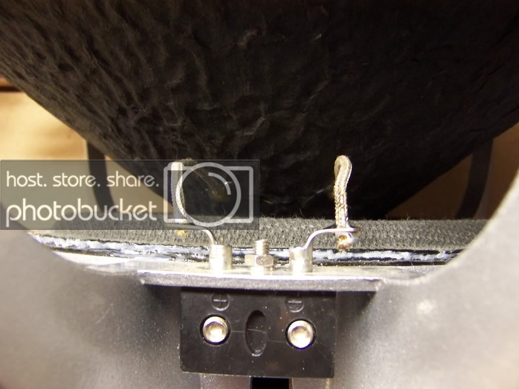

i replaced the terminal block (the seller will know why //content.invisioncic.com/y282845/emoticons/verymad.gif.3f39c5c2fd57527b671fad3efdfac756.gif//content.invisioncic.com/y282845/emoticons/furious.gif.fc81ca146dbff91fede3ed290dbc4f4c.gif) and wired in some 8ga so the sub is set to go.
***Big thanks to Ray @ Audio Innovations for the terminal block***
sorry for the shitty pics..

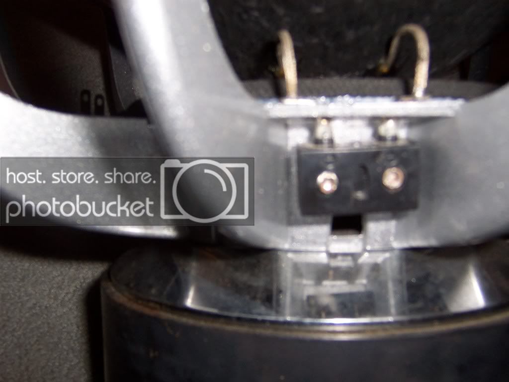

Stripped set screw

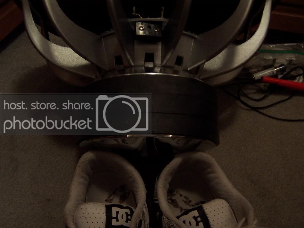

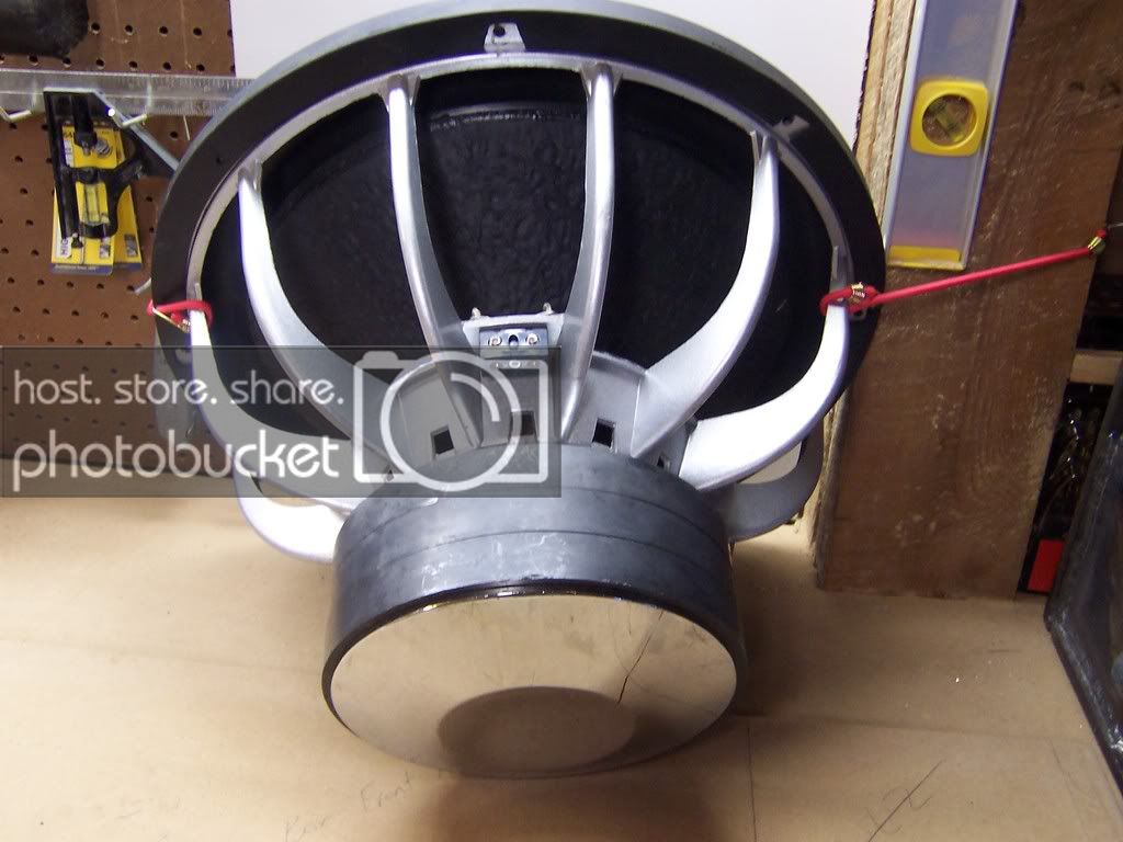

Had to hold it up some how..

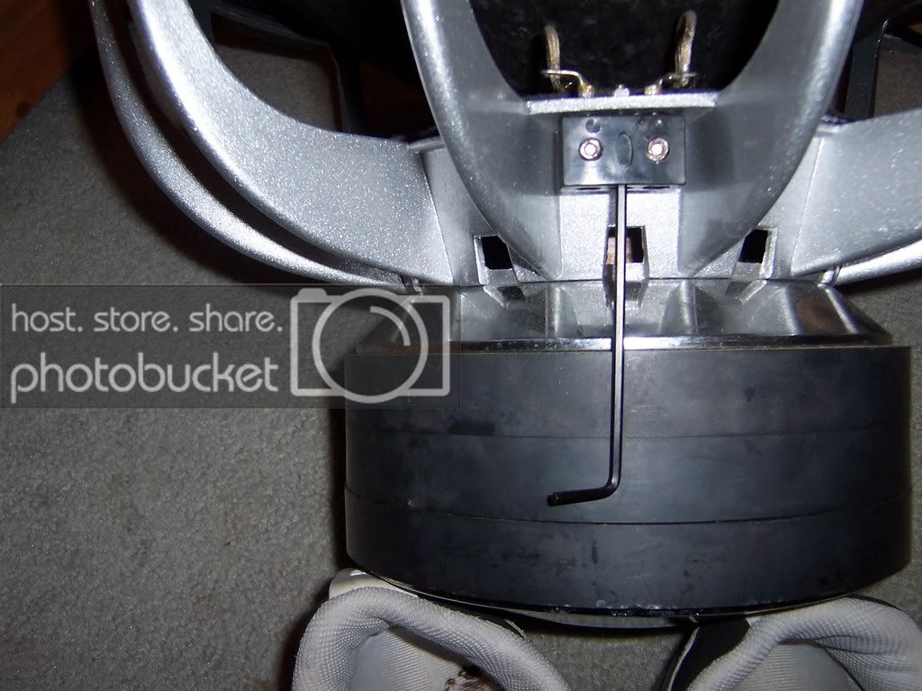

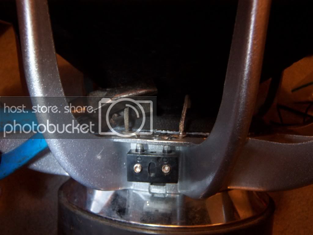

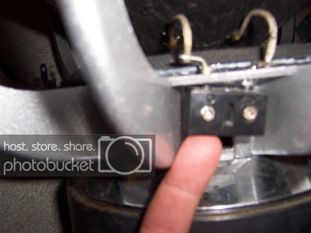

Using an allen wrench to loosen the bolt holding the block in
Terminal block free

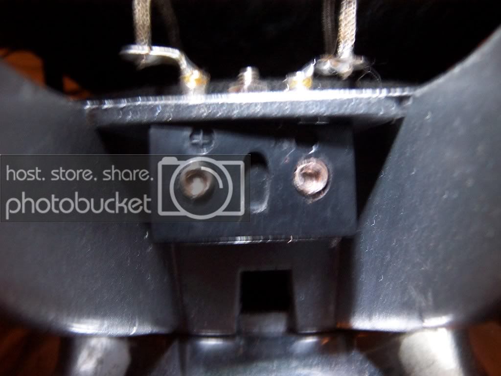

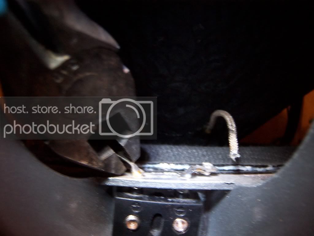

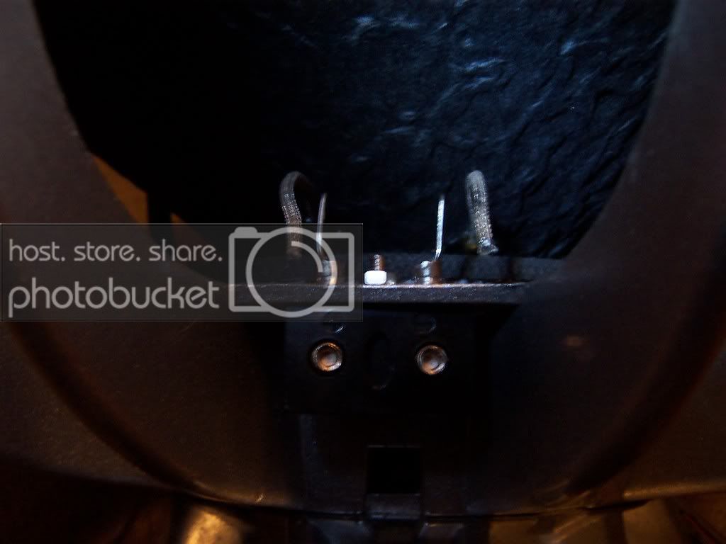

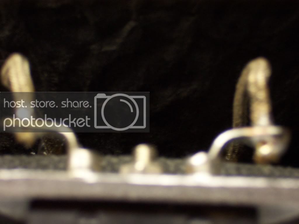

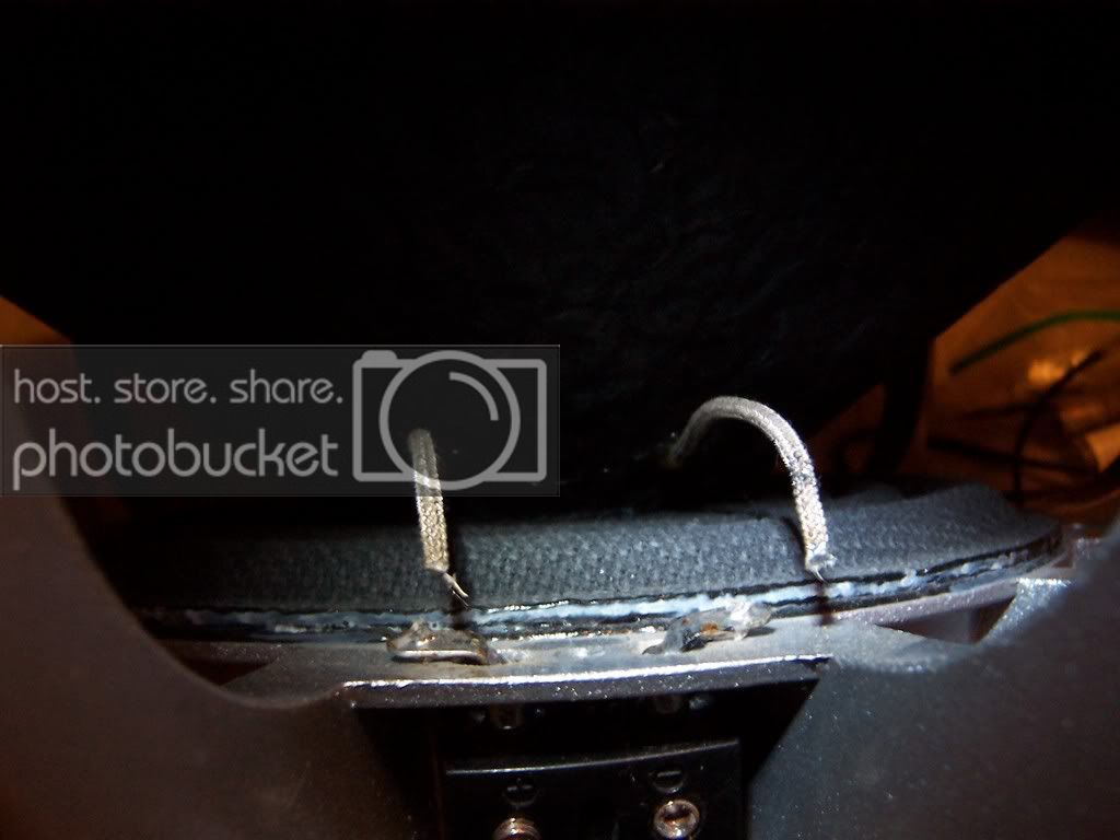

Cutting the tinsel leads close to the old block, leaving as much of the old solder on as possible

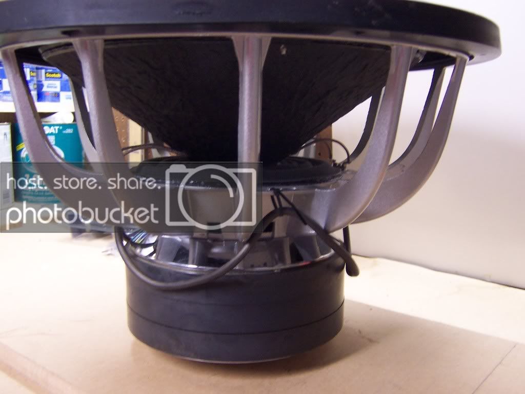

Depending on what subwoofer it is, the leads will have to be bent upright to remove the block

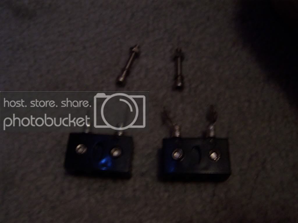

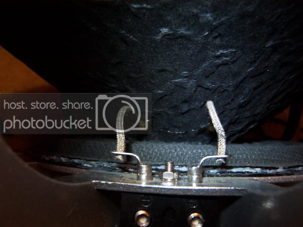

New block/old block

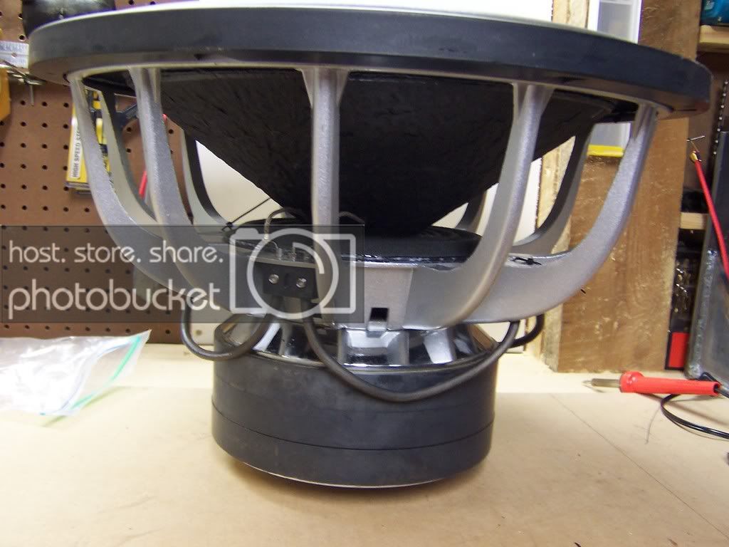

New block bolted in
