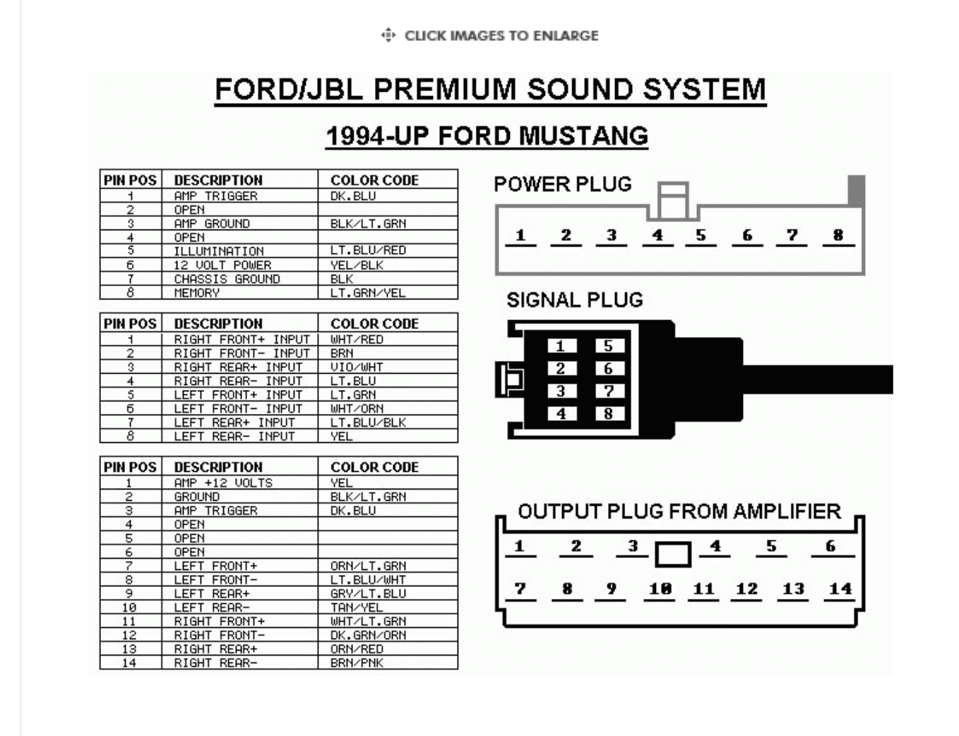

Are there wires on the other side of those OEM amps?
Just did a quick google.Google.
The circles in the image are what's visible in my Pic. The arrow would be the back of the units (not visible)

After checking a few sites I will assume the rear small plug carries the audio signal from the radio. There are no splices in the front plugs which I will also assume are the speaker outputs and power inputs. Then the black wires should be spliced at the speaker locations, and that could mean the OEM tweeter wires are still plugged in. If so then that would explain why your radio protects itself when the amp is plugged in.
Furthermore, if the OEM tweeters are still connected they could cause sound issues like you currently have. 2 tweeters per side is not pleasing IMO.

I think they connect the radio to the speakers at the amp connectors. You should see the black wires splicing there.

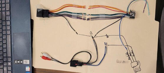

Update/Questions. Please excuse the length and possible confusion (confusing for me anyway)
Haven't been able to search the 4 speaker wires yet... because kids... but in the meantime picked up a new Pioneer harness so I can keep the crap AS IS in the car, and make sense of this at the table here.
For reference again, Im using this guide: https://www.moddedmustangs.com/thre...d-system-installation-00-04-mustang-gt.38963/
I have attached the image of where Im at currently following this guide.
Quick Note: the Pioneer harness at the bottom is wrong. I have the new one on the way, but wires are the same. I just drew the Orange/White (Dimmer?) wire it will have that this one doesn't. The 1 still in the car taped to sh*t has orange/white, so does the 1 arriving tomorrow.
In the guide above that Im following, I am here:
"You want to connect all the regular wires normally. Now here's where it gets a little tricky. Take the 2 Black/white amp grounds on the RCA plug harness, and using a 3 way heat shrink connector, wire these, plus your dimmer/illum ground (orange/black), now take your 2 blue/white amp wires on the RCA plug harness, and using a 3 way connector, connect all three of these wires together..make sure you add another 3 way connector in somewhere down the harness so you can add an aftermarket amplifier later on down the road. don’t try to splice it in…this creates a bad connection. make sure you use a lighter to shrink all the connectors around the wires so you have a nice solid airtight connection that won't come undone."
1) I do not have a Orange/Black wire on the pioneer or Metra harness (top right)
Should I do the regular Orange here? Lost. Any inout as to what the following steps should go to?
2) Am I reading correctly:
2 Amp grounds on the RCA + Orange
Then
Take those 3 together (2 amp grounds + orange (?which?) spliced) and splice to my 2 blue/white Amp power wires into it?
Totaling 5 wire spliced into a 3way? 2 ground from RCA, 2 Power from RCA, orange?
Sorry this is a mess. If its too much, I may abandon and just deal with it. Blah. Was hoping for a quick fix, but they bunged it all up.
Not losing hope, but yet another roadblock for my brain
Cheers everyone. Hope this is at least interesting. Lol
This is one complete step.
This is another complete step. It is the 2 from the RCA harness plus one from your Pioneer harness. It reminds you to add another 3 way in case you want to add a sub amplifier .
No, I suspect the Orange is Positive. I assume he included the Orange Dimmer wire as "regular wires" because there is no mention of it.
If he called them amp grounds, then they are probably meant to supply ground to the radio's dimmer, but the radio already has that.
Ok thanks.
Im lost at the "connect all 3 together part" here I guess.
Ok i think i get this. Should i ignore orange here?
I could also wait to share the correct harness tomorrow when i get it to eliminate confusion.
Might have a minute to pop a door off too and check the speaker.
That would be good. I am curious to see where those darn wires go to.

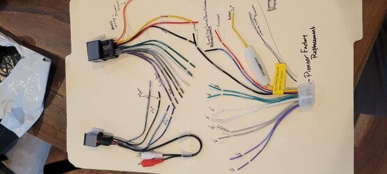

Got everything cleaned up here. I think I am good on the wiring set up.
After some research last night it seems I need a resistor spliced in too. So I drew that in.
Last step will be to find those cuck speaker wires and redo that part.... hopefully just plug and play.
I will keep everyone updated!
