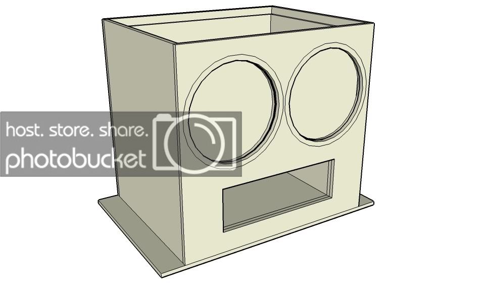

New plans (courtesy of my man Grant [and Tom I think])
Titebond II, lots of screws, this is going to be nice. No bracing has been added but that will be accounted for. I'm still open for suggestions, tommyk has been helping me out a little too. 16 cubes @ 33 hz I believe. Sub/port placement has been rearranged due to the fact that I'm doing a Bass Race only setup now, no need to gain one decibel and complicating the design.
i think you guys should put as much tought on how is the enclosure going to be assembled. just as much as you put on the design of how its going to sound.
im sure you guys got it down this time around.
keep us posted.
