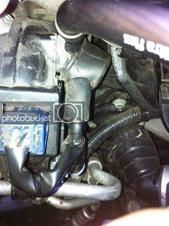

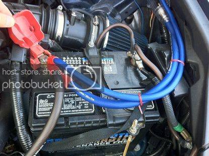

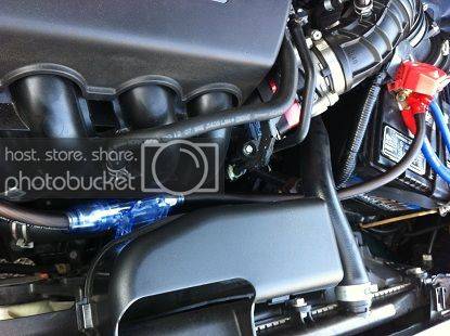

here are the pics of how its wired
Why does it look like you have 1/0 for power and 4 gauge for grounds?
Because I do lol. I have 5 ground points though. I bought a groundin kit made by a member on another forum so I jumped on it. It's good quality cadence 4 gauge wire along with my stock ground wires
I haven't upgraded to 0 gauge yet
