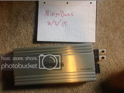

VFL 4480 (has problem)
NinjaBass
Low Bass Lover
12 0 0
VFL4480
Powers up normal and will play perfectly fine on some songs but on others when it hits a certain bass note makes a nasty noise
90 shipped
on me
You were clipping the amp.
Its known on these 4480's to make a weird noise on clip.
Your volume can be different to the other guys due to headunit voltage
