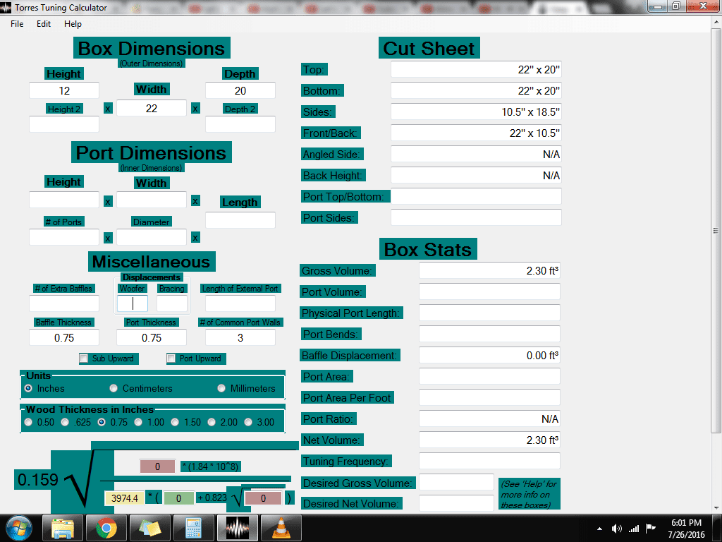

However with the enclosure, you only have 12 height. subtract wood thickness which is 1.5 because top and bottom thickness is 0.75 each with 3/4 ply or mdf. and you only have 10.5 inches left so fitting a 12 is a no go with that height. You pick the sub size that works best to your space to get the best enclosure design possible. Not whether you want to run 12s or not.

You have 2.3 cubic feet before port and sub displacement so after those are taken to consideration you'll most likely end up with 1.4 to 2.0 cubic feet of usable airspace. You'll want 10" subs that can work well in small enclosures. Or two 8 inch subs that work better in medium to large enclosures.

However if you can do the back area, that would best and should get the loudest with that orientation. However to even think about running what kind of subs, you need to measure out what kind of space you will have left. because you might not even have enough mounting depth behind the rear seats and most subs we recommend have a big motor and basket which requires a lot of mounting depth.
So we need the Depth x height x width of the rear area.

4.5 cubic feet, you can actually do two 15s sealed or two 12s ported. However I dont trust what people claim. I trust you measuring the actual depth x Width x Height. Without those dimensions dont even bother shopping for subs period...
