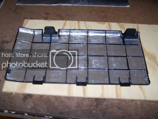

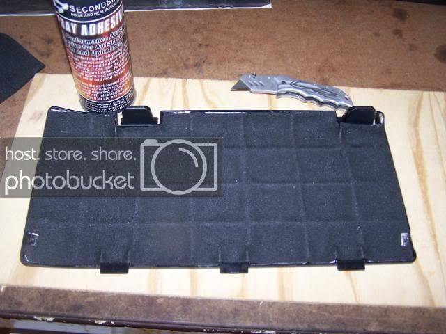

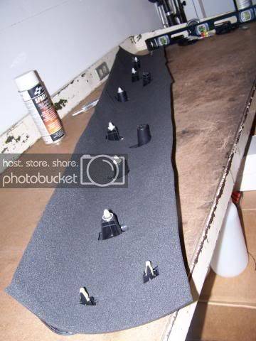

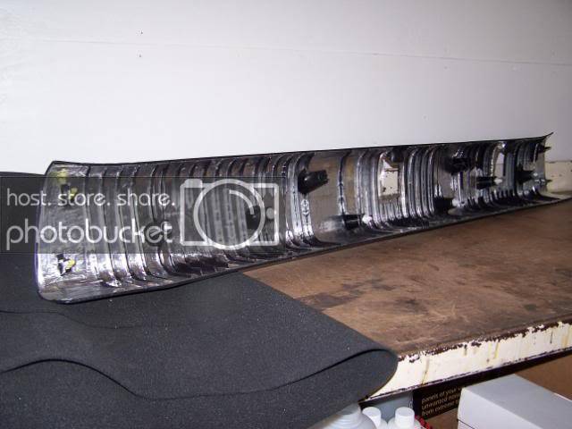

whats the plan on deadening the plastic panels?
Right now, nothing. Second Skin makes rattle pad, but if nothing rattles.....
I'm thinking this thread needs to be stickied right to the top. Absolutely How To Deaden.
Simply amazing and have to applaud your dedication and determination to leave no stone unturned. Ripping apart the interior is no small task, putting it back together will be even larger.
so is that the rattle pad you applied?
No. That's the Overkill.
i have been pondering if i should do that with the rattle pad or if i should use the overkill?
It depends entirely on your goal. Use Overkill to deaden the panel. Use Rattle Pad if the panel is actually moving with bass, driving, etc.
Rattle pad is to be sandwiched between the panel and the car. Overkill is thinner, but it will have a better dampening effect.
