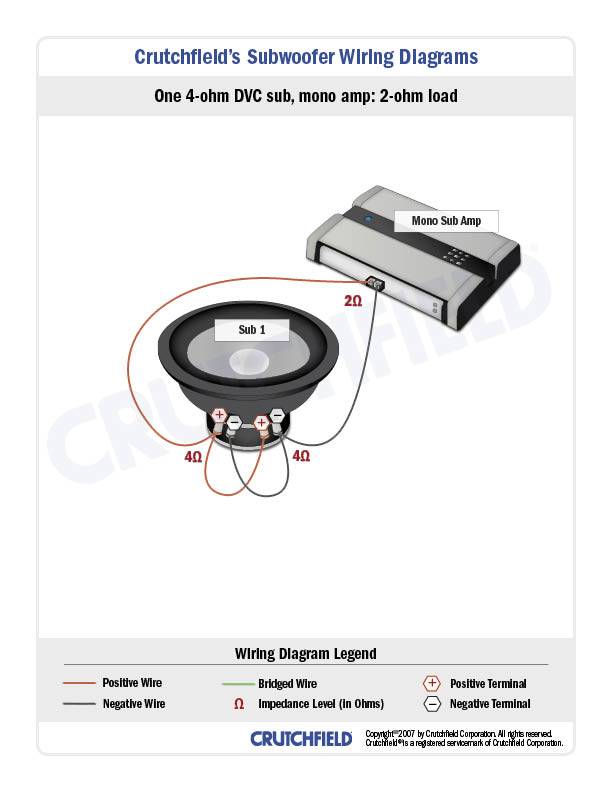

I have 4awg power wire running from battery to amp with inline fuse @ battery. I have 4awg ground going from amp to a part of my car which i scraped all of the paint away to leave bare metal. I have connected this with self tapping screws. I have a remote wire going from my amp to the blue/white stripe wire in my hu wiring harness. I have RCA cables going from my head unit to to the amp. I am using 12 awg speaker wire from amp to sub, using this wiring diagram as reference (have also used the rockford one, which says the same thing):
I turn my car on, amp power light comes on, sub doesn't hit. I tried changing the wires, wiring a different way, still no luck. The only thing I can thinkof is that the sub isn't getting a signal. There are 4 rca connectors on my hu, one says sw the other one is unmarked I believe. There are also 4 on my amp, one set says input one says output. I tried switching them around, but I assumed it should be on input and sw. Also, the RCA's have the built in remote wire that I'm not using because I'm running a different turn on already. Could this be the reason why its not working? I've tried everything I could think of.

Did you cut off a bit of the insulation before you wired your sub to your amp?
No? I'm supposed to do that??
Just kidding //content.invisioncic.com/y282845/emoticons/wink.gif.608e3ea05f1a9f98611af0861652f8fb.gif
Yes lol I stripped the ends of the wires
