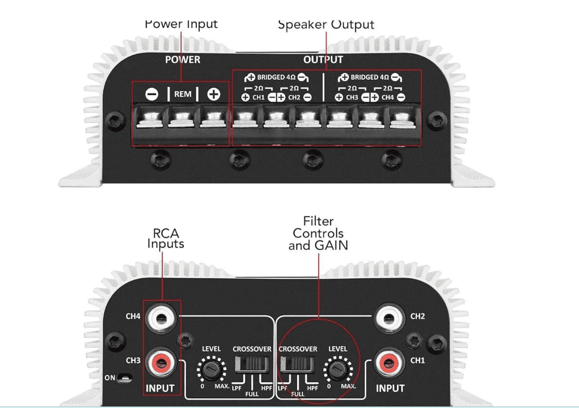

You were supposed to cut the speaker wire off the factory harness
Either way your amp already has an loc built in
Look on the amp rca side where it says high input auto remote
That is your loc so you can eliminate the scosche loc
You will need to cut factory speaker wire the end where signal is coming from the headunit will go into the high input plug on amp
Then run speaker wire from amp speaker output to the other end you cut where the factory speaker wire is going into the door speaker
This method you won't need rca's and you won't need a remote wire
Also for good measure remove your loc wiring and cut out that section with t-tap and rewire back to factory to confirm everything is still working correctly before you jump back into it

The amp doesn't have high input plug...

Ya looks like your amp has 2 versions under the same model
One with high input and one without
