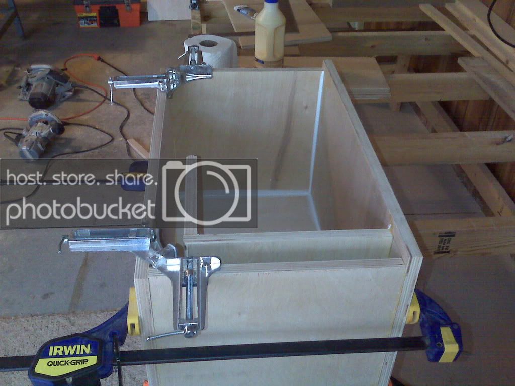

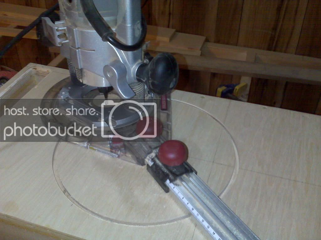

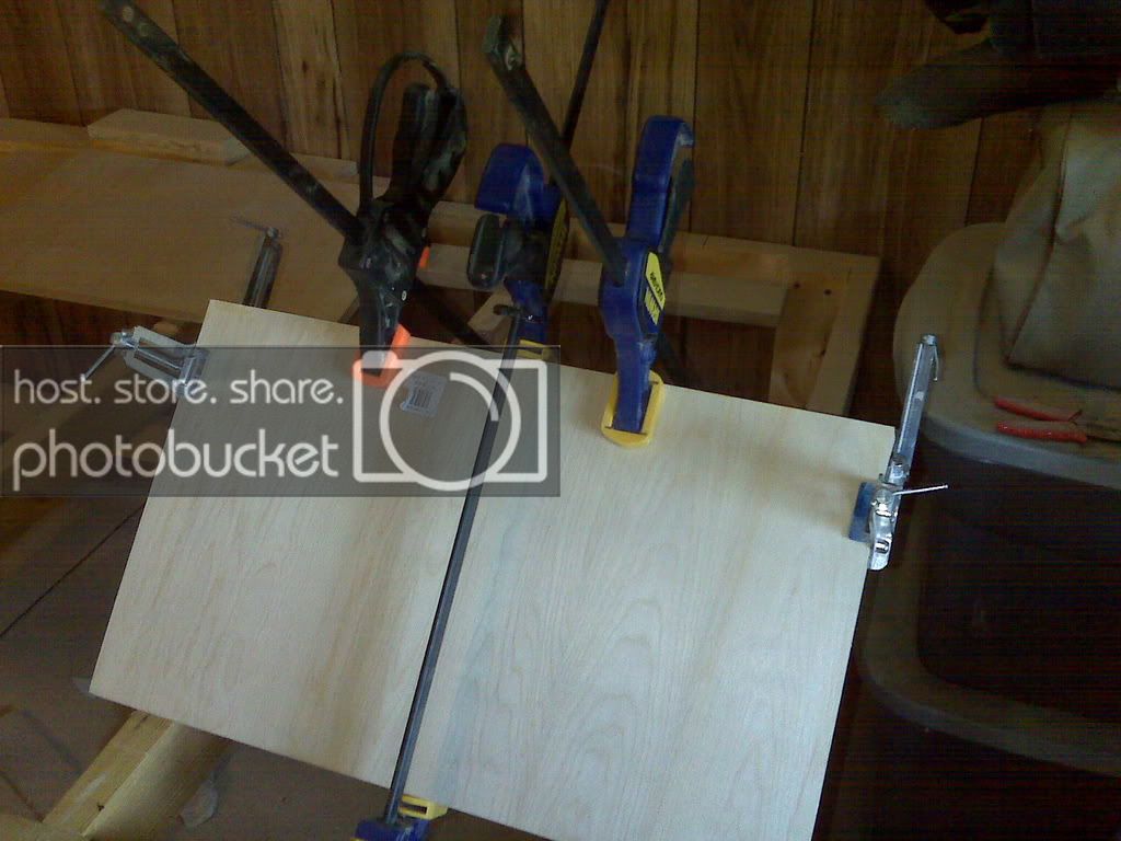

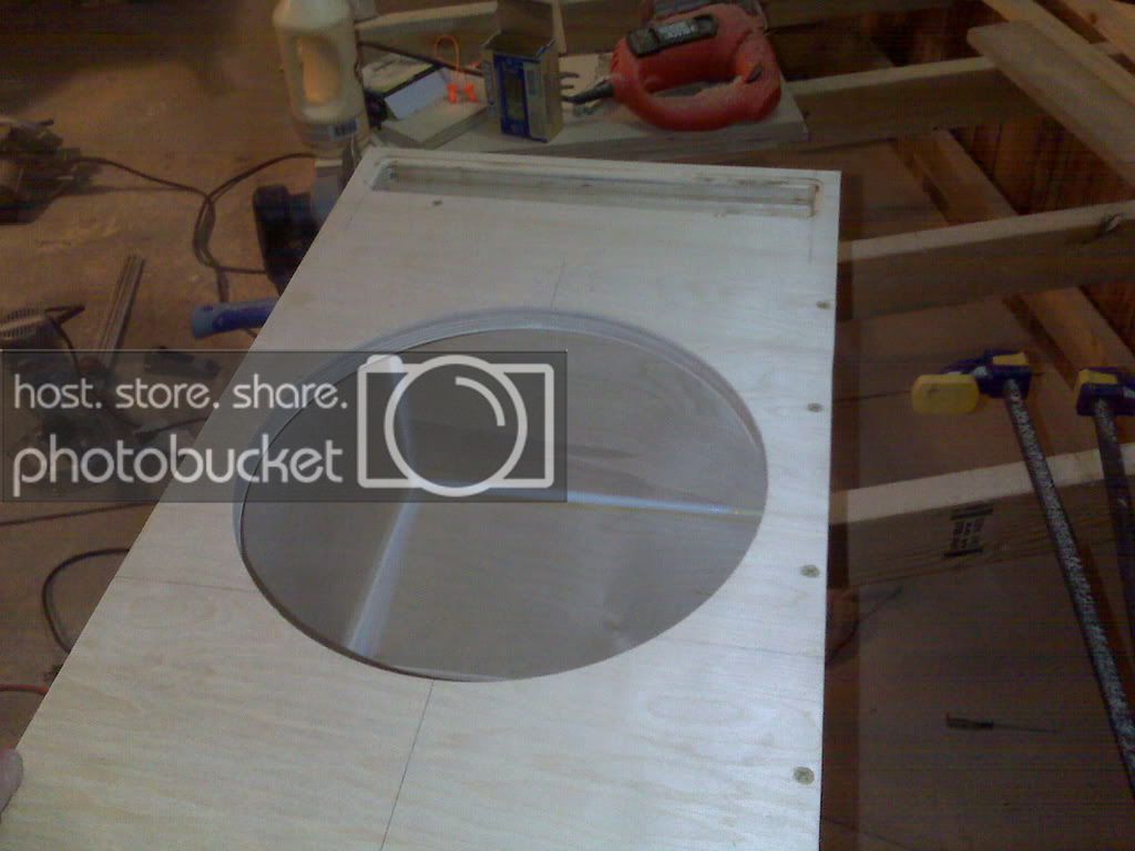

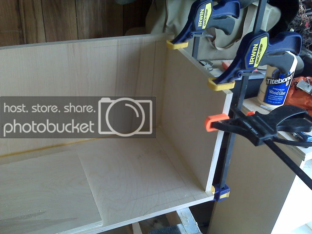

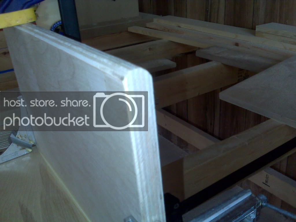

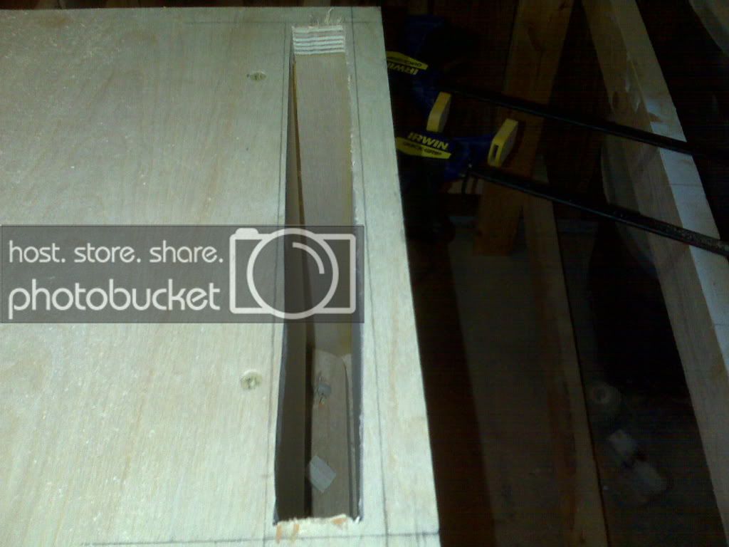

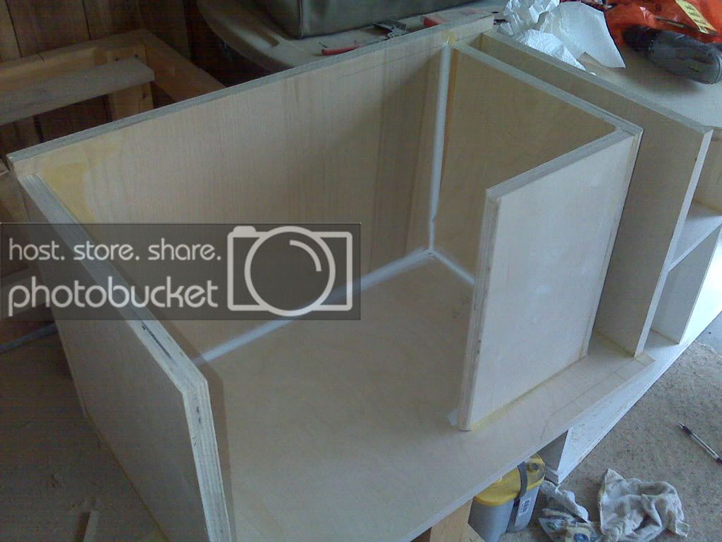

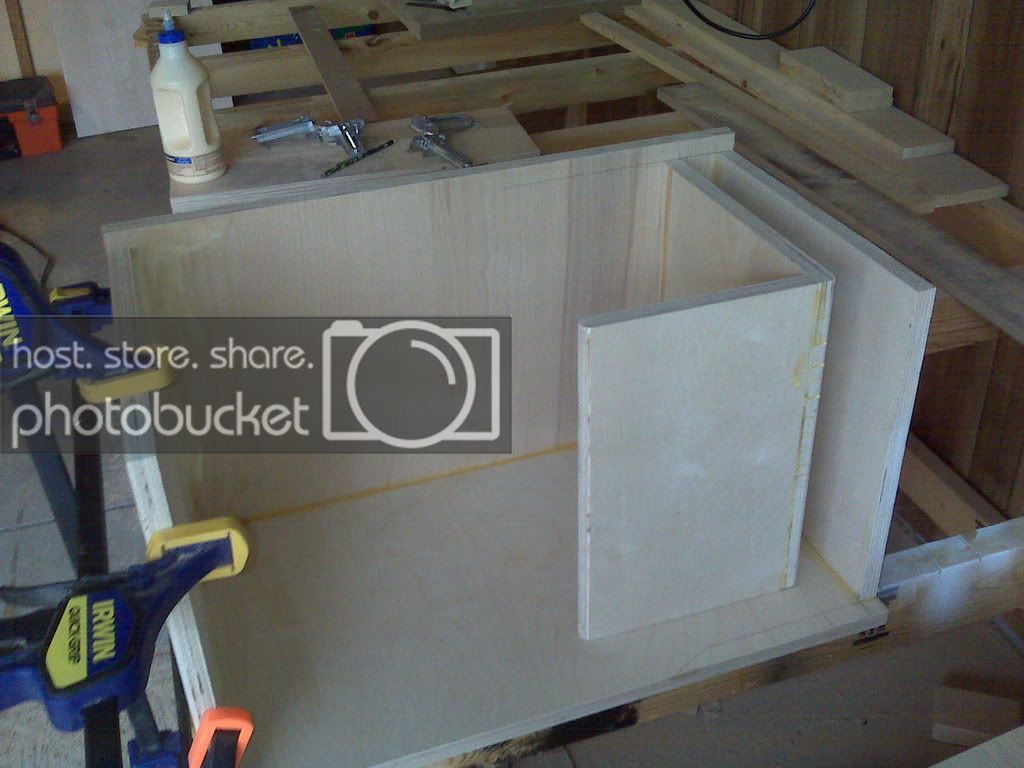

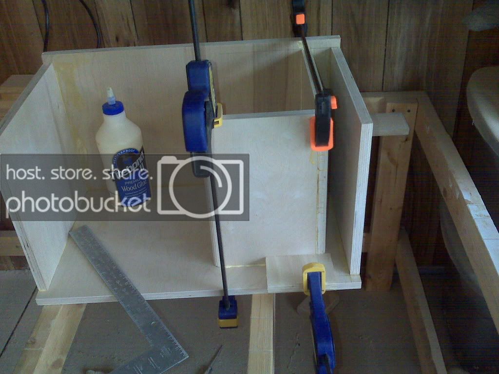

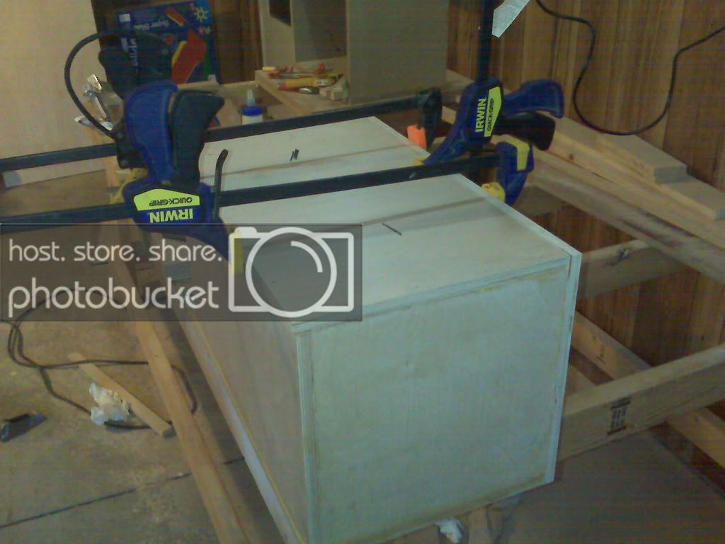

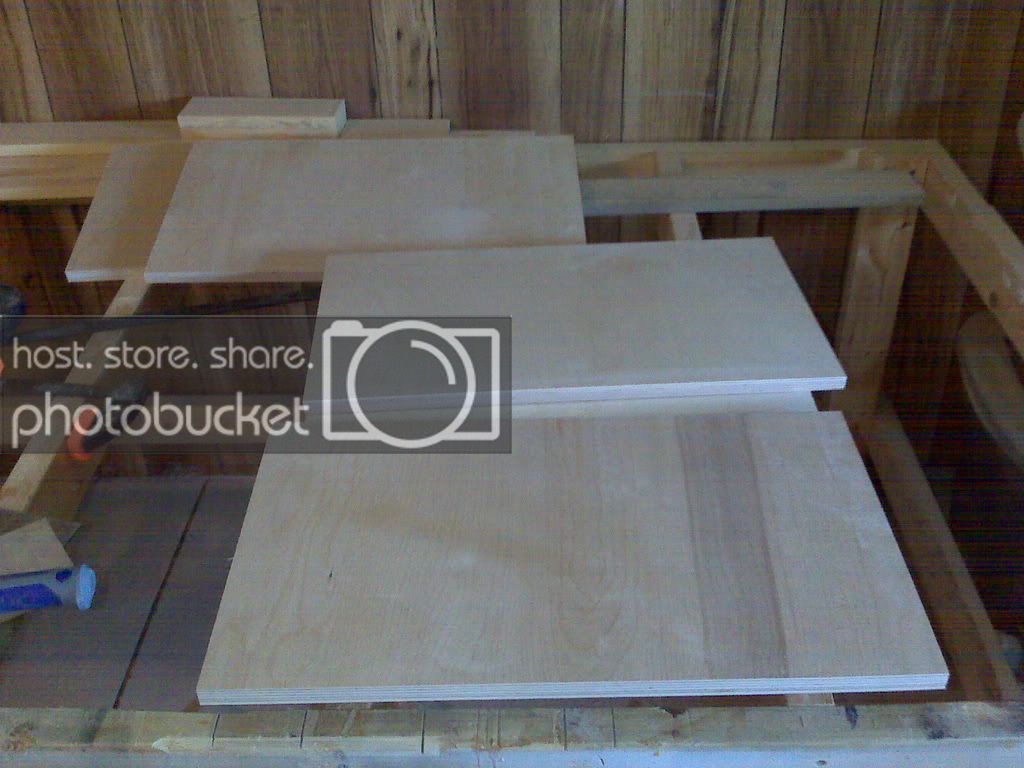

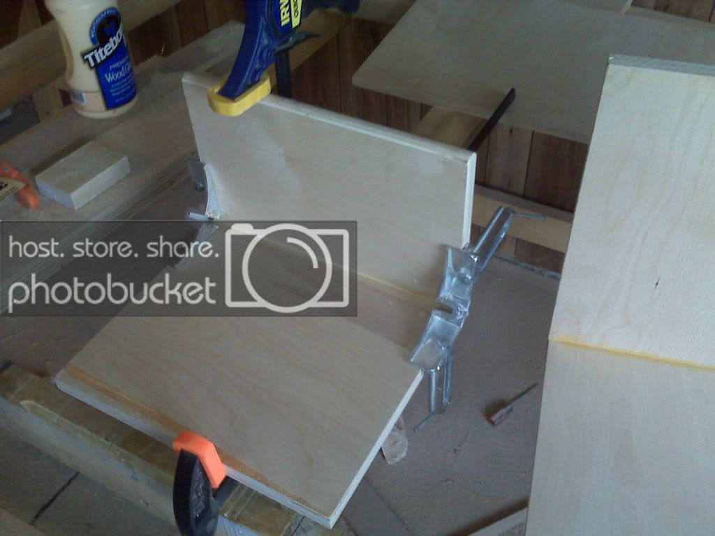

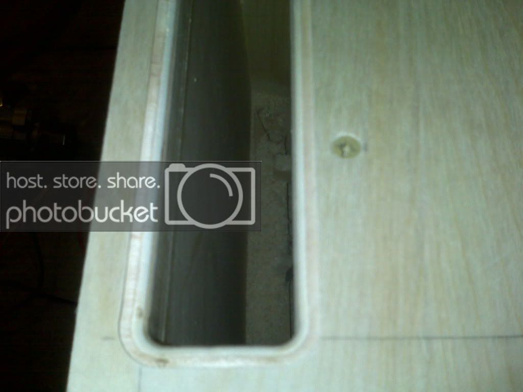

Box build for another member....1 type R. 1.5cf@33 hertz. Went to the store and they had some 13 ply birch mis-priced so he gets a birch upgrade for free!! Sorry about the poor quality photos...blackberry FTL
skillz look good but box is too small and not enough port area, imo.
its not an spl setup or anything....the box is fine. 1.5^3 net with 18sq. in of port. I've built this same box before for my wife's brother and it wangs pretty good. Thanx for skillz comment.
