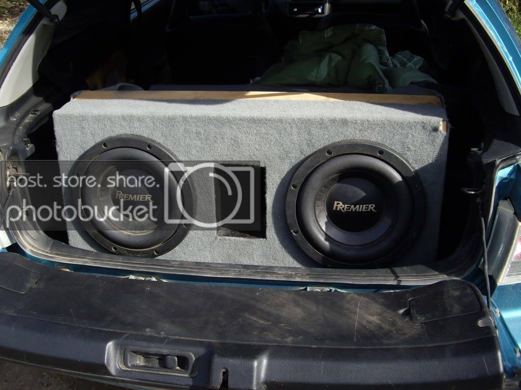

Old box is falling apart, and looks / sounds like crap in the car, so with the help of CA.com I've designed a new box.
2 X 12" 2000SPL (Premier) subs, almost 6 cubes (Might screw some lumber in to shrink it later) 50sq. in. of port, tuned to ~34hz.

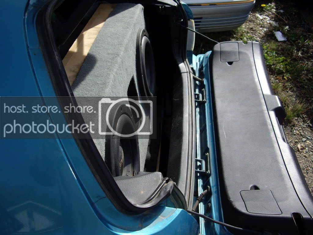

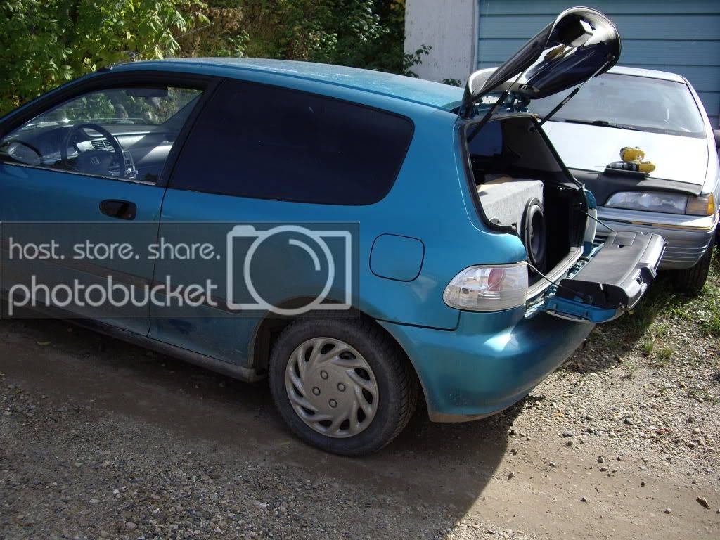

The back half of a very dirty civic!
Little closer view of the old box X 2

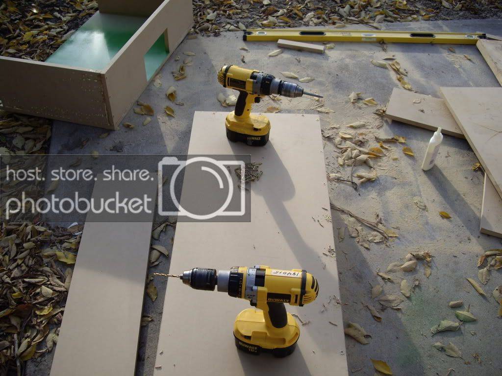

Pieces cut out, all but the port
and the FAIL!!! (This is where the box sits)
Attempt #2 in the works as I type!
Green port FTW!

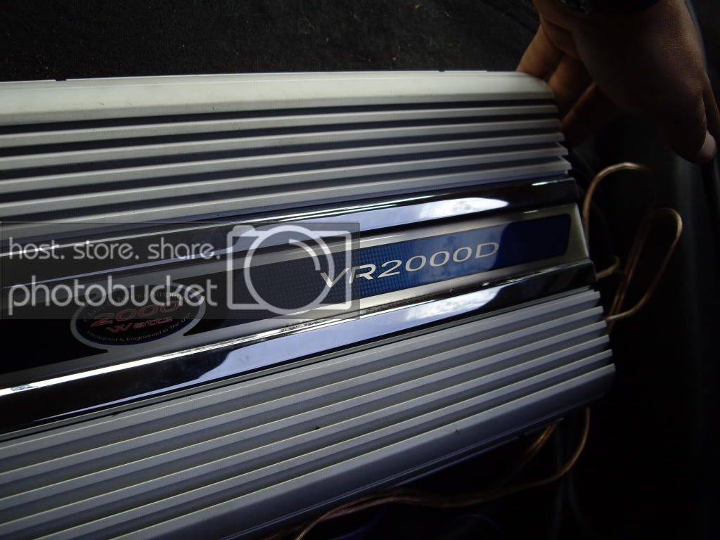

and finally for another hour or two, the beast that makes the boom boom
