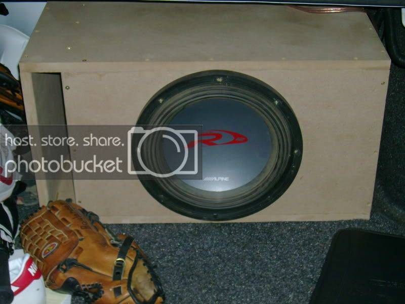

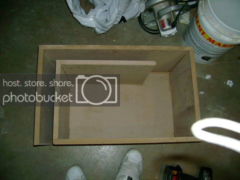

here's what it ended up like.... the port isn't attached yet in the first pic
I used RE's box calculator
well... tough to say how much it cost. It took less than a sheet of MDF, a little bit of glue, and some screws. If you dont have clamps, saw, router, etc. it will be quite a bit more unless you can borrow them.

that design looks good except the port is a little small. Total port area for mine was around 30 square inches. Also make sure you have enough mounting depth for the type R. I cant remember how deep they are off hand.
