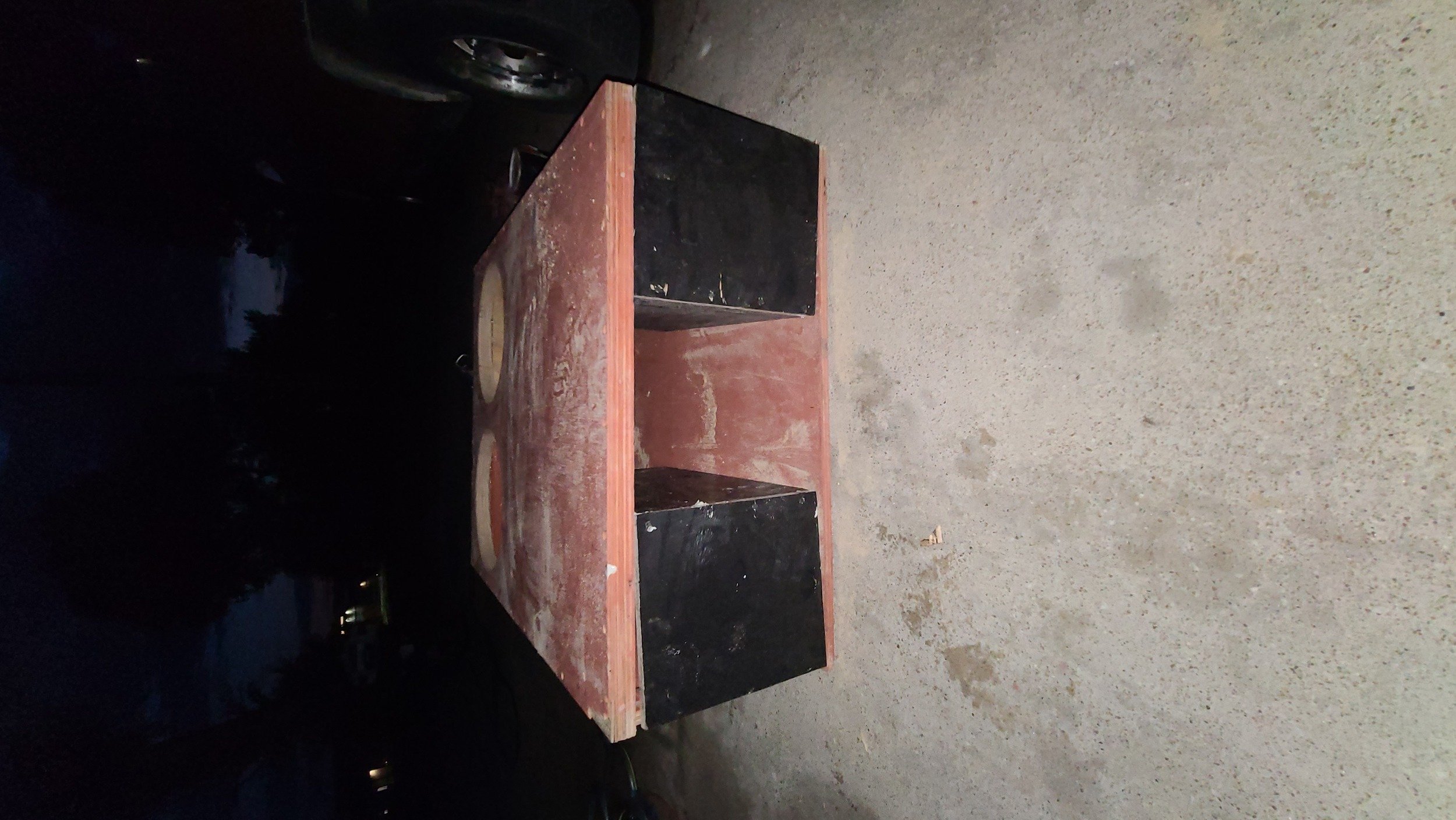

Got any pics of the box in its current state?

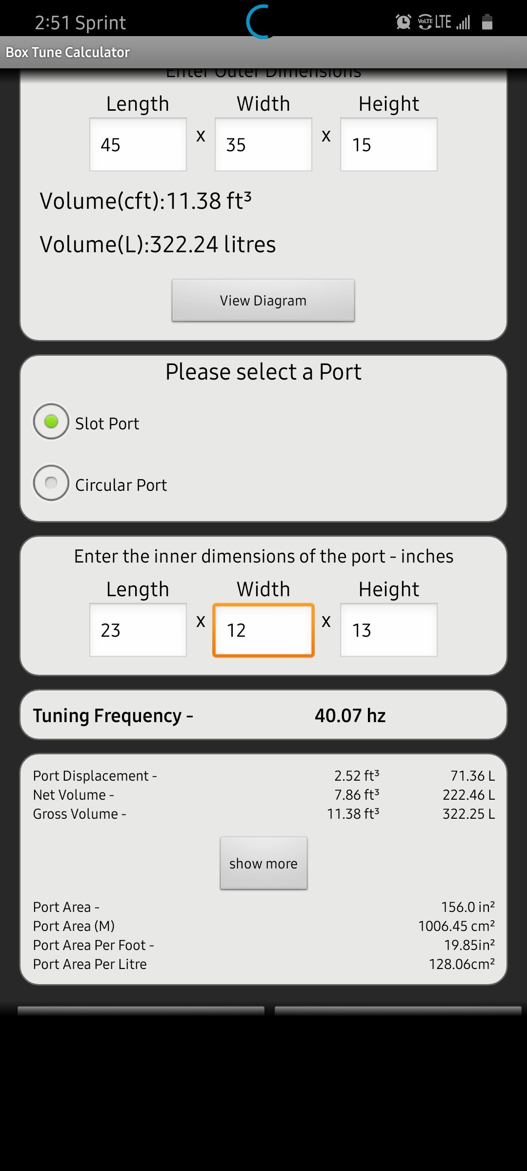

That's some SERIOUS port area above imo... I'm guessing you have it tuned super high, are wanging away way under tuning or your ssf is set incorrectly as well.

How much port area should they have?
Got pics of it in there? 156in2 of port is a tad high but not a deal breaker. You said its finished so I'd love to see it in its current state. Adjustable port?... it's a square/slot?
Realize that bandwith will be reduced with a 40hz tuning. Don't be surprised if your ssf ends up being in the mid-hi 30's as I think that amp has a 12db/octave slope. And limiting anything under low 30's at full volume might be a good idea too. Spl has tradeoffs and bandwith/musicality is a big one.

Yes, let's see how the box sits in the trunk. You already went from 8.7 cube to 7.7 cube, how much volume do you actually have? What are you using for source (music/tones) to determine which is louder and how your response is?
Have you checked for flexing in that box? The bottom is a big piece for just 1 layer without any bracing (2x3, 2x4, or even 2x2 works fine and is cheap). Are you certain every seem is airtight? Are you sure the subs are seated tightly? I really think you must already have a box you can work with by now with some tweaking and care.

Thank you for your input as well shredder.....ok so the first box was 7.2 net with 120in2 of port tuned to 39hz
Second one was 7 cubes tuned to 34hz with 121 sq in of port
Right now its 8.5 cubes tuned to 38hz with 145sq in of port

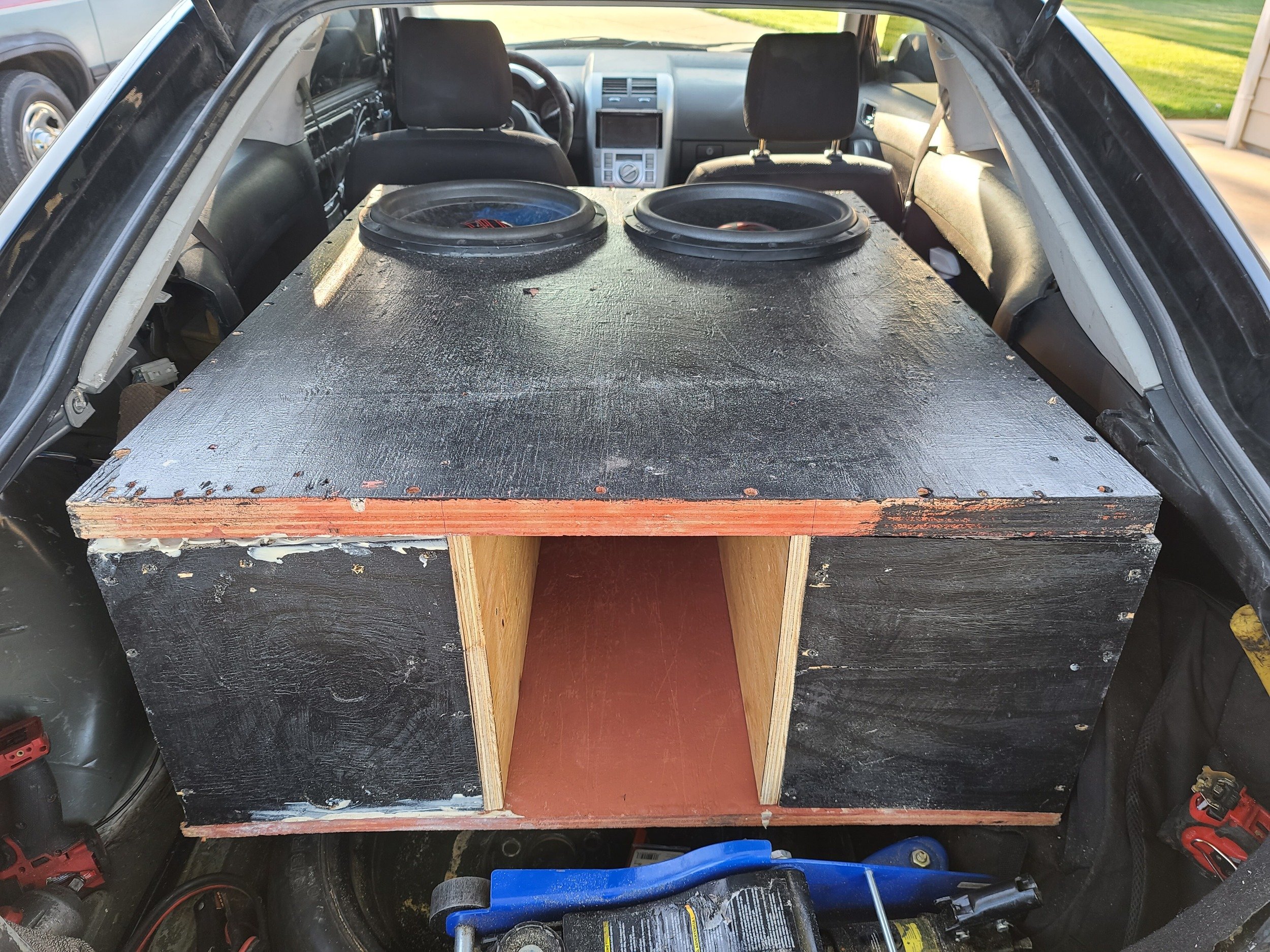

What I'm seeing there that may be holding you back is that with the hatch closed there's no room for the wave from the port to get up and to the front. Not sure how far the port opening even is from the back of the vehicle but if it's really crowded it can also cause trouble. Might also try to double up those port walls too, I'm betting those are flexing a bit and you could lose 1.5" side to side and not notice much difference in tuning. Bonus points cut the insert pieces with 45 degree angles so that it makes a flare going in and out of the port.

I still can't understand why you weren't opening the 300A fuse trying to run through that. Let me ask again, how much space is between the box and the sides and hatch? I just wonder if you're not getting the wave from the port up to the front. I'd almost say you could shorten that box by 6-8 inches (modify port as needed to keep tuning @ 38-40hz) and come out better.
