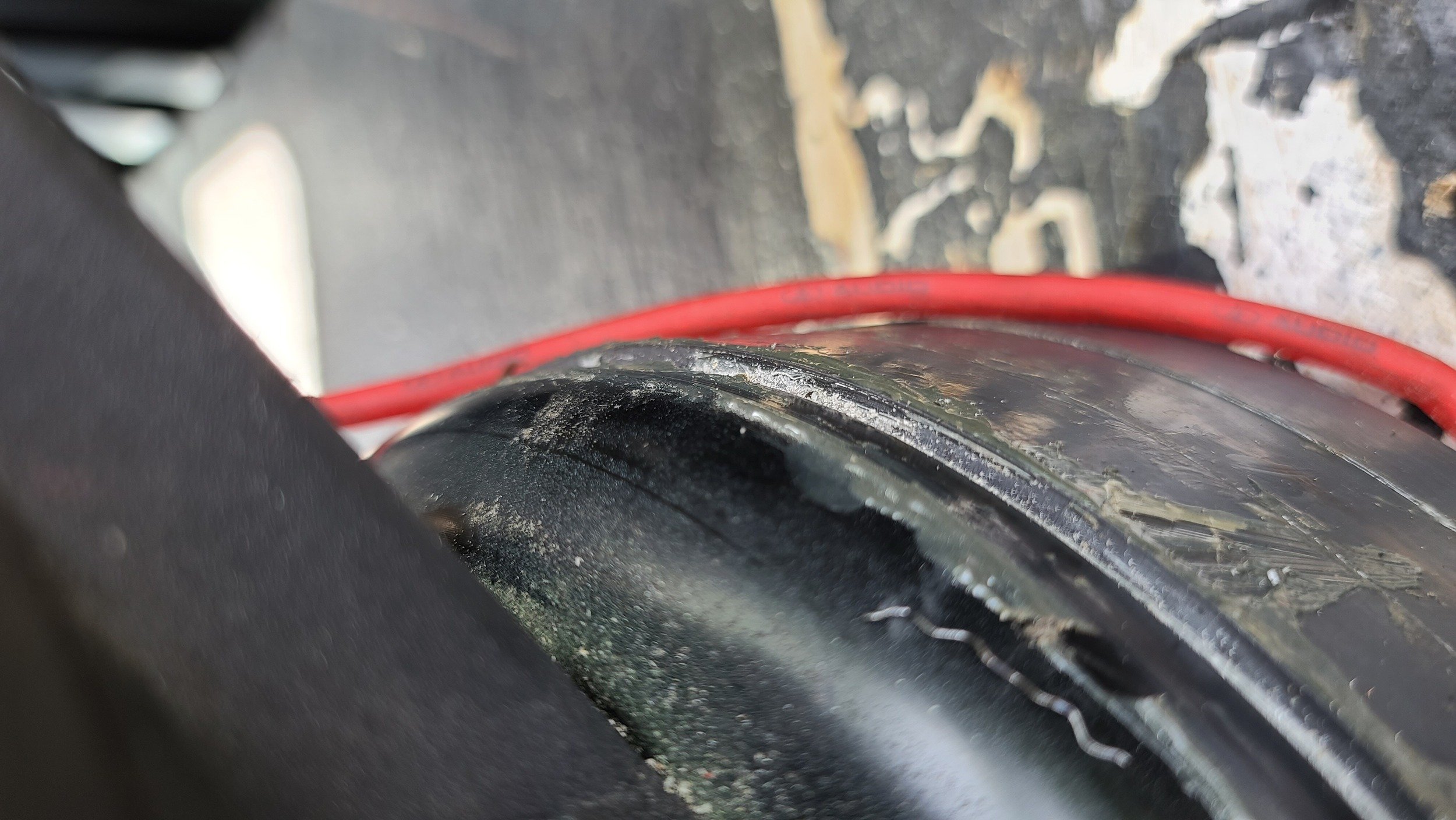

So somehow the motor shifted slightly and the soft parts are frozen.....what the fuuck do I do? Im so pissed off right now...i went ahead and ordered another recone....$194 incase anyone is curious. But the spiders are on back order for two weeks. When i ordered the other one I got it the next day. I hate this stupid shiit
Give me a few minutes and I will definitely upload some pictures for you guys
Pics? Motors do not shift for no reason, it normally takes a drop or other serious shock particularly something like DD where they're not using cheap ass glues. I suspect you just slinkied a coil or something but if the pole piece shifted that is absolutely not anything you want to mess with.
I can't imagine how that happened short of someone dropped it at some point. May even be just the slugs and top plate are a bit off center but the pole is still centered in the gap and you just slinkied the coil.
You'll need to get the softparts dug out of there anyway so might as well try to carve out all that. Might want to get the frame off too since you'll want to ship it out for realignment if it's actually shifted the gap. You can use USPS large flat rate box with some foam (and definitely insurance) to ship most motors which will come out a lot cheaper than trying to pay by the pound.
Thats what it is....the slugs are off centered....i couldn't think of the proper name lol....so is there anyway I can attempt to fix it? Because I've already dropped $400 on two recones in the past 2 weeks. I dont really want to spend anymore money trying to fix it cause i know there's other subs that are far better than these 9500's....i picked one up for $230 and the other i traded two meso 18's for....
When it happened the other day I was on the highway and I started playing them and they played for a few minutes just fine. And then all of a sudden it sounded like metal slapping and then it obviously froze in place. I drove over a set of train tracks. But they weren't to rough. Fairly smooth.

That's unusual for DD. Trying to separate magnets that big and reassembling is dangerous. I would not even consider it.
Dunno what you think you're going to get for better subs period much less for less than the cost of sending it back to DD for alignment.
