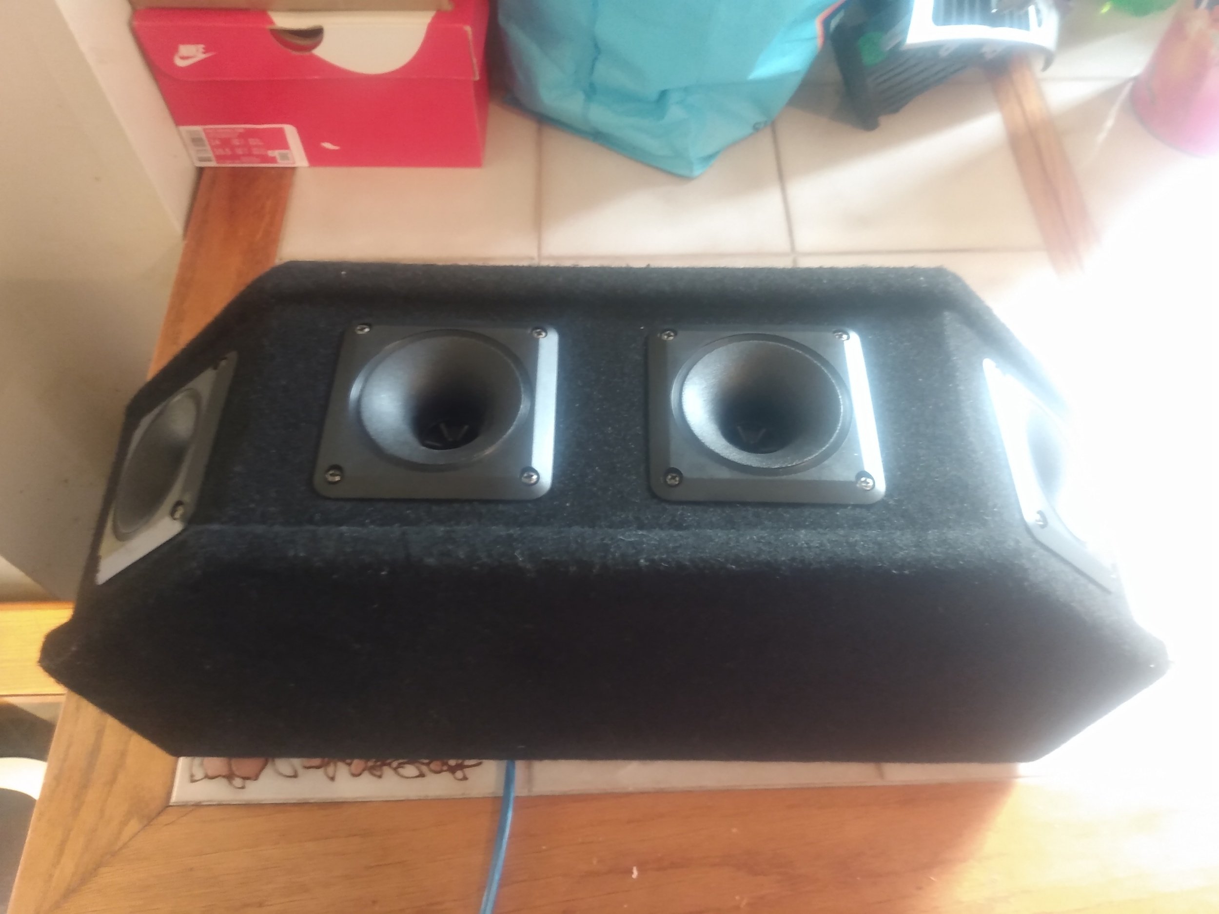

Tweeter Box? You mean a crossover? Kind of lost here
This is what I mean I'm trying to add it to my system in my car
Do you own an amplifier? Do you even own a head unit?
Not to come off as rude but you might want to consult with a reputable shop to get you going with this.
I have the whole system Head unit amp and four 12's Just trying to add some treble
You need to find out what ohm load they are showing. So us a DMM and measure the ohm load. Find an amplifier that will accept the ohm load. Example: It measures 4ohm I would look for a 2 channel amplifier and run it in a mono configuration. Left positive right negative on most 2 channel amplifiers.
