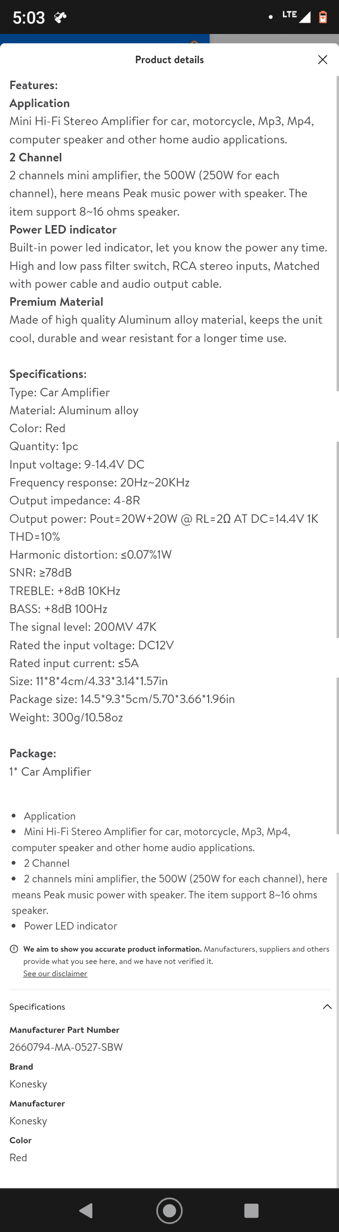

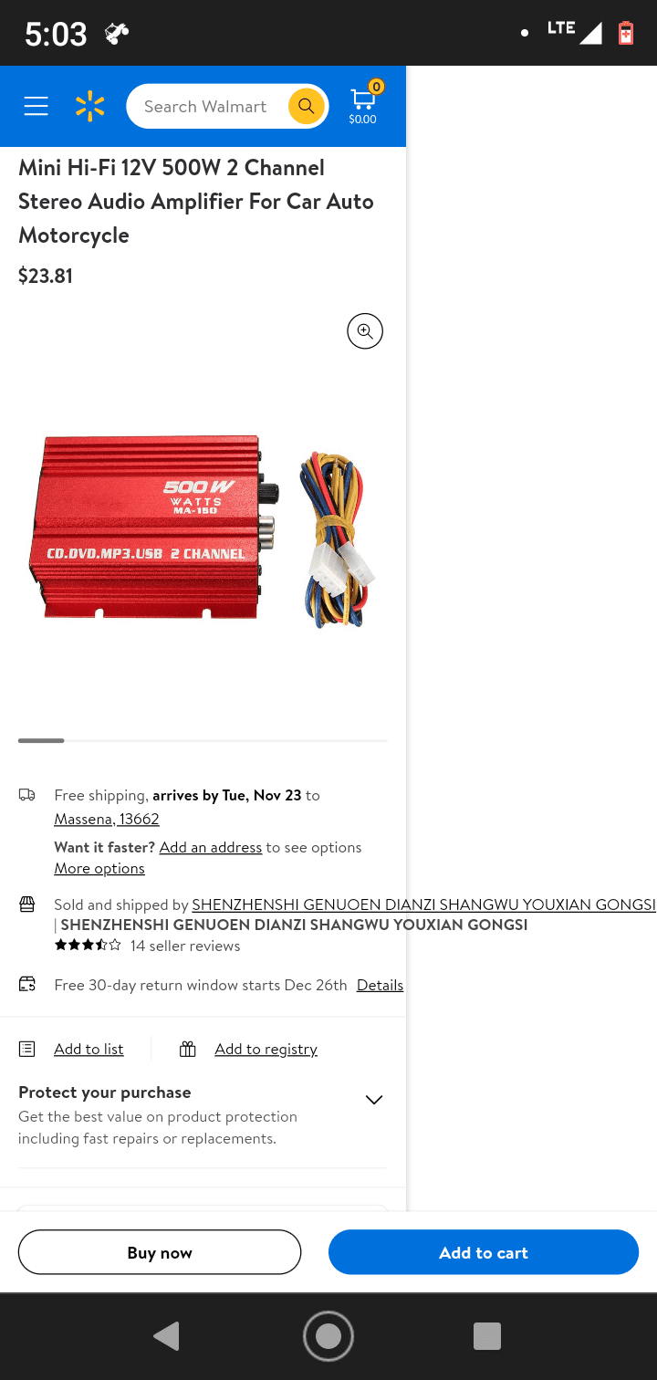

It says 8 ohms and 300 watts
I can do it if I can just figure out the amp. And wire hook up
One of your amps should have RCA outputs. Use those to feed the tweeter amp. Power and remote wires from the distribution blocks you mentioned. That amp is 8-16 Ohms capable so it will not do. Find a 4 Ohms bridgable amp. That way when you bridge, it will play into a single 8 Ohms load. Make sure it has a built in x-over.
