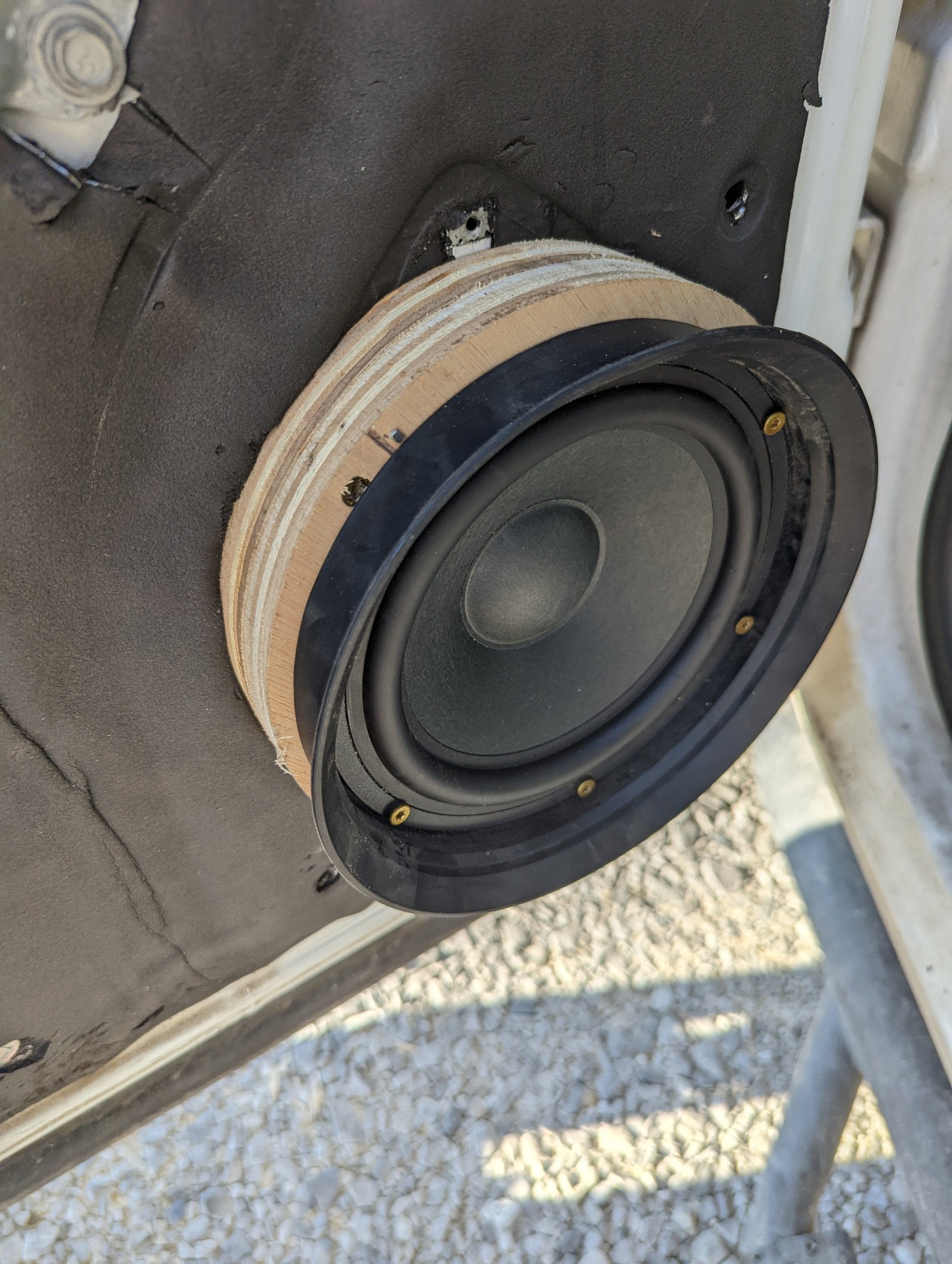

Have you sealed the openings in your doors?
Have you done any time alignment? And are you sure the speakers are wired in phase with wash other.
They definitely should be moving a bit so it sounds like a crossover issue.
Doors should be sealed to the best you can

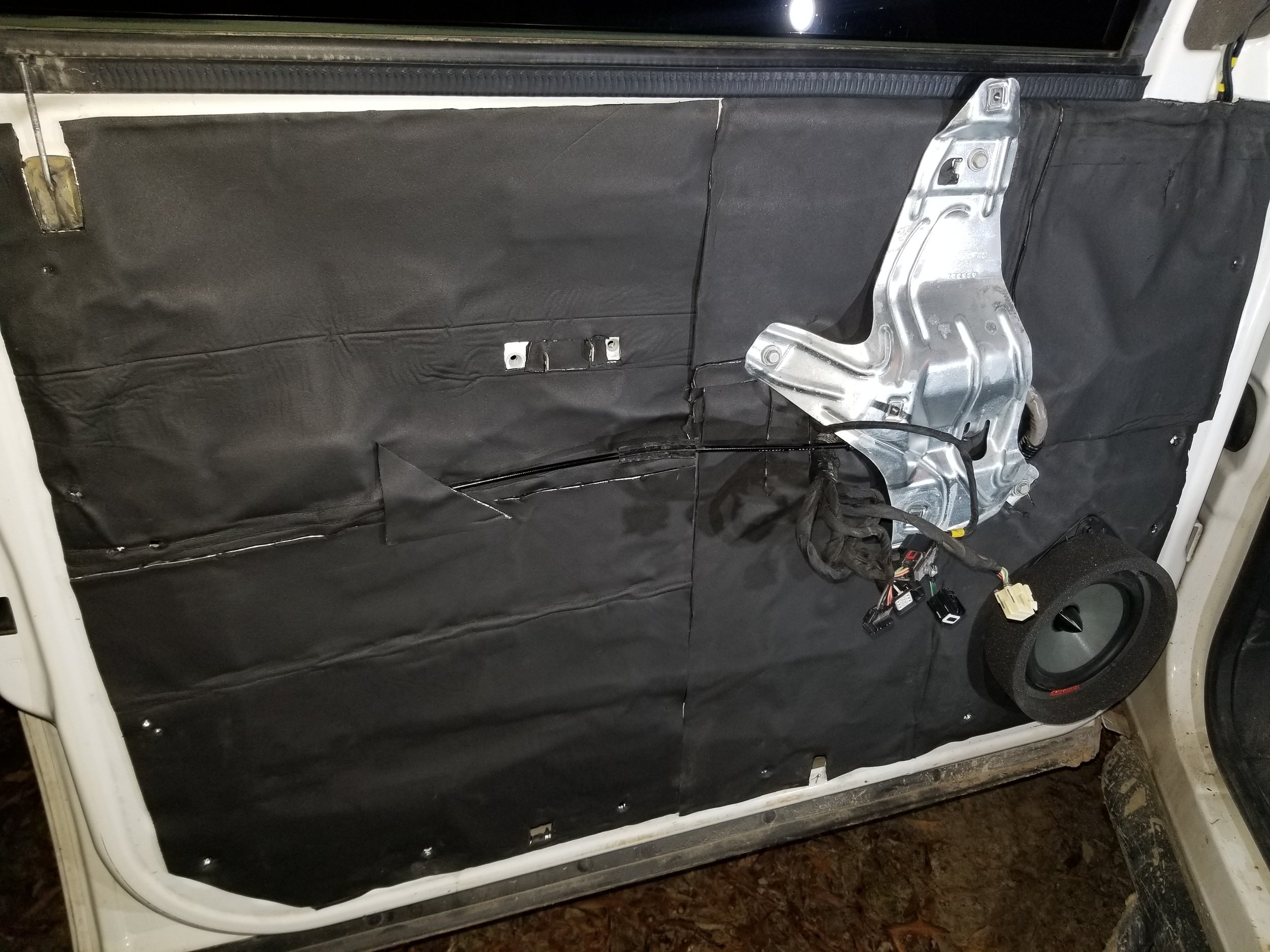

Thanks for the response Winky
how much mid base are you getting out of yours?
Doors are sealed close to what yours look like.

Mine have quite alot of midbass but my doors are very well sealed, my mounting rings are solid, I have the seal ring, and currently they are seeing 80-125w each.
