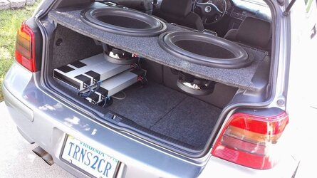

I'm a noob who has no idea what I'm doing, but I'm looking to learn. Currently I'm running a Sony Mex-n5100bt for the deck
Skar Audio SDR-15 dvc 2ohm powered by a Rockford Punch p650.2
Two Rockford r2d2 12"s powered by an Alpine mrv-m500
The 12s are in a sealed enclosure, as well as the 15". I bought the 12s a month ago and everything was fine till yesterday when one of them blew.
 Is it possible to find a ported enclosure for 2 12's with subs for $300? I don't want to get the bottom of the barrel equipment anymore, but I definitely can't afford the best.
$300 is pushing the limits for my budget, so I'd even be cool with something used. I can't buy right away, I'm just looking at my options ahead of time. It could be about two weeks from now.

Why even buy more equipment?
Seems to me that you've got some space available if you got 3 sealed enclosures and mixing drivers/sizes is never a good idea.
I'd recommend using what you got to start and re-enclosing that 15 in a ported box with the punch amp.
Maybe selling the surviving 12 and alpine, buying some wood and joining the ranks of DIY enthusiasts who have actually learned how to build their own enclosure.
The result MIGHT surprise you.

x2, i wouldnt get new gear.  id build a box for the 15" or buy one and run it only.  i wouldnt run the 12" with it.  no need
Cool. I'm ordering a ported 15 box this week and ditching the 12s. Can't wait to hear the difference.

So I bought a prefabricated ported enclosure for the 15" and that's the only sub I'm running. It hits harder than the 12s and 15 combined when everything was sealed. Now it's just the 15 ported. I also installed a passive eq which is extremely convenient since my musical tastes vary. And I'm running an amp for the mids. My throat almost tightens up depending on what I'm listening to.
I'm glad some advice was taken eagerly and happy it worked out for you... if you ever want better lows (deeper/lower) try an actual custom enclosure tuned and configured for your vehicle/music tastes.
You'll most likely see an improvement over any Qbomb prefab.
