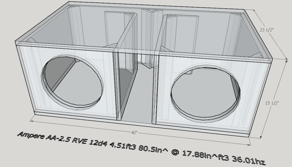

I bought two 12" Ver 2.5 Ampere Audio Subwoofers and a custom ported box hand built by the shop for $700. I then bought a Ampere Audio AA-1200.1 to run them for $349.
When your son gets ready to upgrade (we all seem to... lol) If those Ampere 2.5 12's are still functioning (my experience is that he'll want it louder and turn the gain way-up... or his buddies will) I'd go about 2-2.5k next time and get the next box built to account for that increased power. I'd bet 2.5K on that box below in that Small SUV would be fairly impressive.

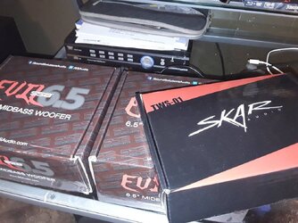

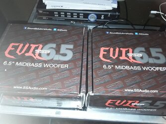

 My son's SSA Evil 6.5 arrived  today. I am VERY impressed with the shipping of SSA and WoW those speakers look amazing.. I guess I had a brain fart when I ordered and didn't order the components (100% on me, not SSA they sent exactly what I ordered) so I ran by local shop and bought a pair of Skar tweeters.
 OK here is my question, Do I need a inline cross over, like the kind in component sets to hook those up? or can I add a bass blocker to the twtters and do fine? Should I wire them in series? I'm using a old school Rockfor Fosgate 300.2 Amp thanks guy.

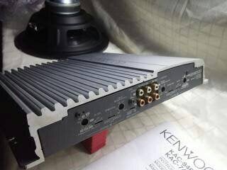

Hey mate, nice gear!
It all depends on which way you do your install.  If you plan to run them on an active stage, or passive stage. :rolleyes:
  • The passive stage is when you add an in-line 6db/12db cross over to the tweeters or;
  • if you plan to run active then your amplifier would do the duty to send the customised signal to both your mid-bass and tweeters; (presuming your say, a 4 channel amp has variable high pass/ low pass/ full range capabilities with variable cross overs for front / rear independent points and separate gain adjustments) :)
If you plan to run passive and that is what your question is based on then, yes, you will need to sought some crossovers from car audio shops, may be worth to contact them before you make the trip to save time. :cool:
See below pics to see if your amp has built in features.

Yeah, you're going to want some passive crossovers for these.   I expect those mids may start breaking up if you try to run them full range and really it's probable that you'd want to cross them rather low and have a larger format tweeter that can also cross low.
I found a few 2 way crossovers with a quick google search for various prices.   Try your luck and report back.
